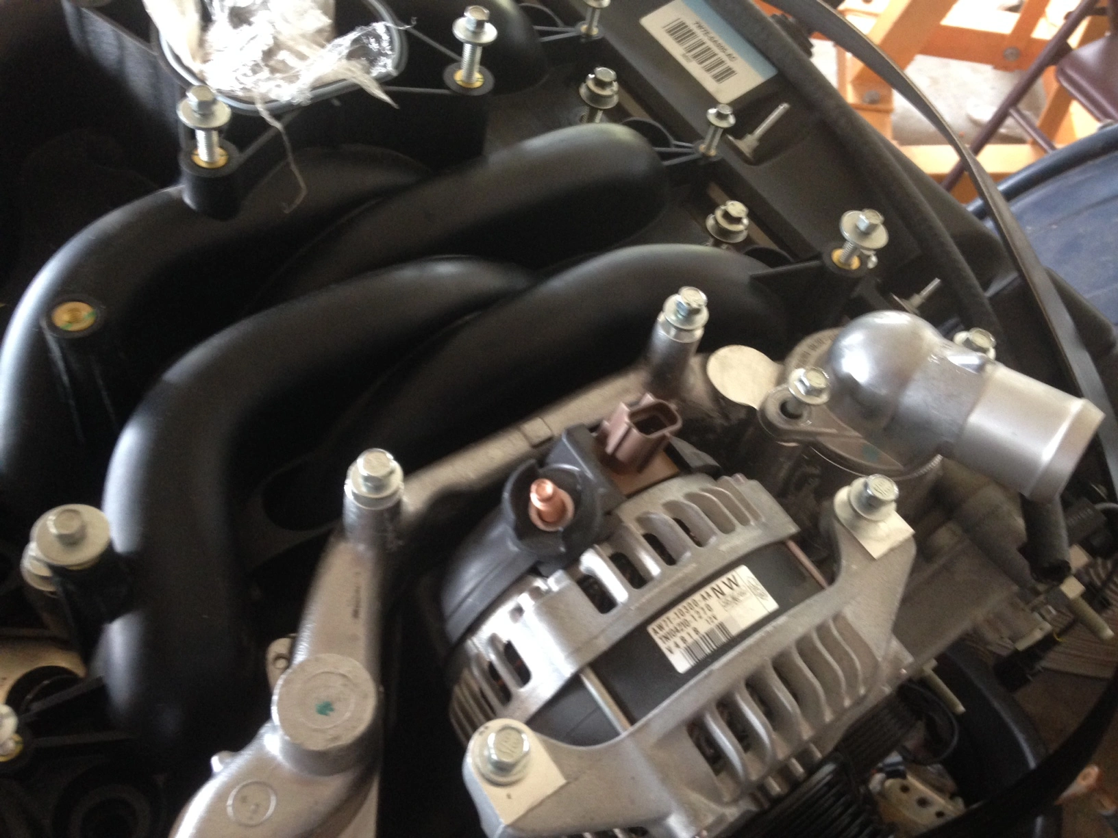

The original 4.6 engine measured the coolant temperature at the intake and the factory new 2010 crown vic looks like it measures it under the intake.
My question is which is better? I like the idea of measuring the temperature at the block.

That's the reason why I asked the question, the intake has the boss area for the pipe thread but is not drilled or tapped. My thinking was they moved it to the cylinder head on the 2010.
I have attached a photo of the manifold.
