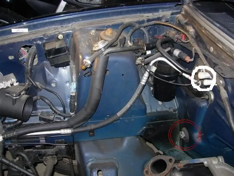

I have a coolant leak coming from a plastic fitting on the passengers side engine compartment firewall just above the exhaust. Attached is a random pic found online to show you where. See the double-lined red circle.
Can anyone tell me what this is, and how difficult this might be to fix?

That looks like the condensate drain for the AC system. Are you sure it is coolant and not condensation? If the heater core were leaking it could drain out of that hole. Does your AC smell like syrup or your defrost fog the windows up more?
Actually, yes, for months now my AC has been smelling like maple syrup. And also yes, there has been a weird fog on the inside of the windshield at night.
It is definitely coolant coming out of that location. I know the smell quite well. And my coolant leve gets low and I see no other coolant leaks anywhere else. But it is only recently as of a week ago did I start smelling the coolant from inside the car. The AC maple smell has been there for a while.
