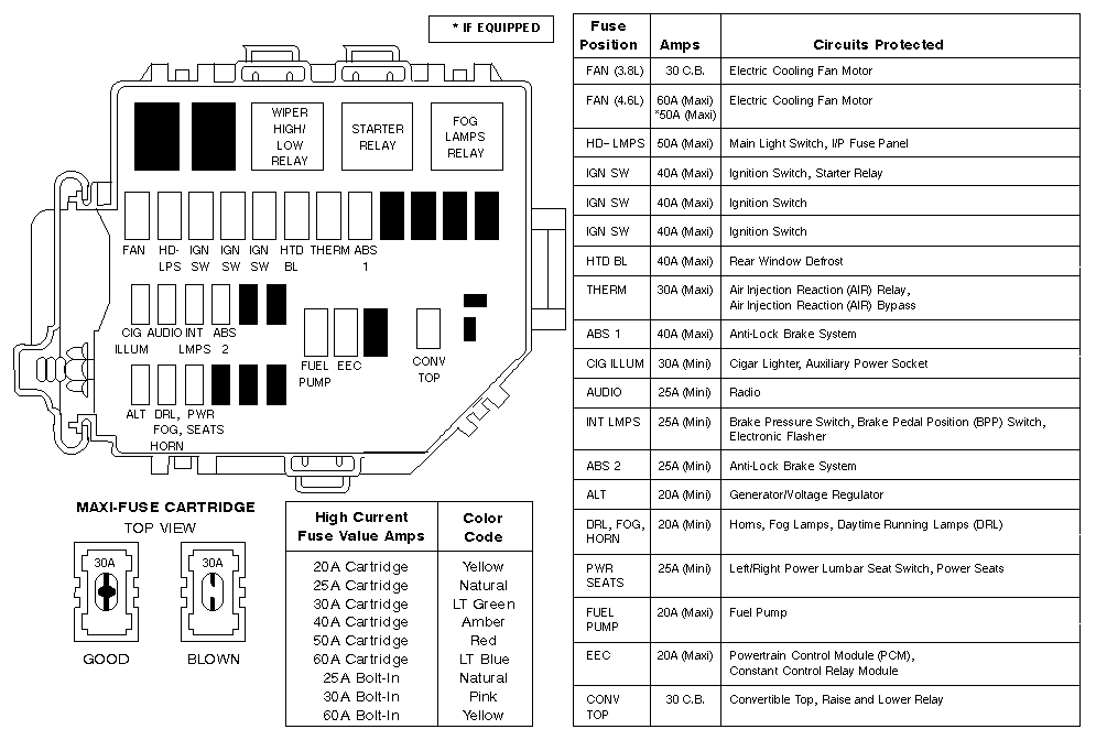

The following diagram is for a 98. Should be similar to yours. Use it to help check fuses. Look over the wiring in the engine bay and fans for anything broken or disconnected.

Go after the cooling fan first as it is most important. When you get to AC...check all the fuses in the system and make sure the low pressure switch is plugged into the harness...a couple of instances here where that was the only issue with AC and if these guys were really fly by night and wanted to make some business, an easy target. Some pictures here:
https://www.stangnet.com/mustang-forums/threads/a-c-low-pressure-switch-plug-replacement.705606/
If fuses are good and low pressure switch is plugged in, but no AC...try unplugging the low pressure switch and jumping the two terminals in the harness (with motor and AC on) to see if the AC clutch kick start in. That's all I have given you have a set of AC gauges. Happy hunting!
