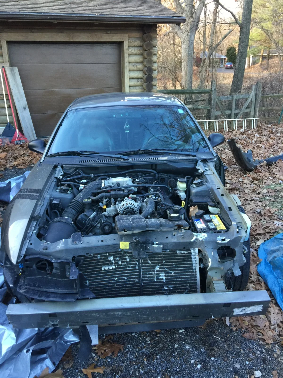

When I’m driving the car and I go to accelerate the car makes a loud banging noise and sometimes grinding (sounds like the noise is coming from around the shifter). I can feel it in the pedal before it happens and during. The car mostly does it at idle rpm (I can be cruising at 30/40/50 really any speed while it’s idling at ~1400 rpm and when I press the gas it will bang but if I continue to accelerate it won’t do it). Car was in front end accident (slid underneath a truck I will try to attach picture). Only mod is borla exhaust. Recently done plugs & coils. Car passed inspection just fine. I have owned the car since 124k and the car was taken to a transmission shop right away and they said the torque converter was shattered and that the trans would need to be rebuilt but that they would recommend a flush. The car now sits just shy of 130k, runs and drives just the same but still bangs. No discoloration on trans dipstick or smells of burning trans fluid (does burn oil as usual in this old of an engine). Another shop told me it may be the torque converter solenoid? I’ve never heard of it but this shop is very far and I want to get a few opinions before driving it there.

Did the Motor get hit when it went under the Truck? The Balancer May be cracked, or damaged- causing vibration issues.

If the accident bent the Unibody, the Rear end itself could have sustained internal Gear & Bearing Damage by Driveshaft thrust, or affected Pinion angle. Either could produce noise described.

I’m not very bright when it comes to cars. I’ve been learning as I go. I pretty much YouTube anything that I’ve had to fix/replace. Unfortunately, I bought the car damaged so not sure if this was a prior problem. The only thing I know that was hit on the engine was the driver side valve cover; the top of it cracked which I replaced. I’ve never had the car spit out an engine code but when sitting at a stop light I do notice it idling funny (almost like a small misfire) cylinder 5 spark plug wire clip is broken which I believe is the cause. I took a video awhile back and it sort of is a shudder I couldn’t think of the best word to describe it.

I find it ironic that the accident occurred, noise you have may be caused by 25 different reasons from that type of Collision.
Was the Frame bent, or was it unchecked for one reason or other? Was it Totalled? You checked the Tranny lines to the Radiatot, no obstructions inside?

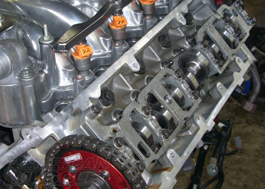

The Valve Cover being struck, that damaged may indicate possible noise due to Valvetrain Damage, as seen; the Cam Timing Sprocket being positioned high above the Valve Cover & other components, a hard strike may bend the Gear & thrust the entire Cam backward and misalign Tensioners below the Lobes, and bend or break the Tensioners(s) themselves. Pic:
The Timing Chains are VERY long to begin with, doesn’t take much to upset the balance.
