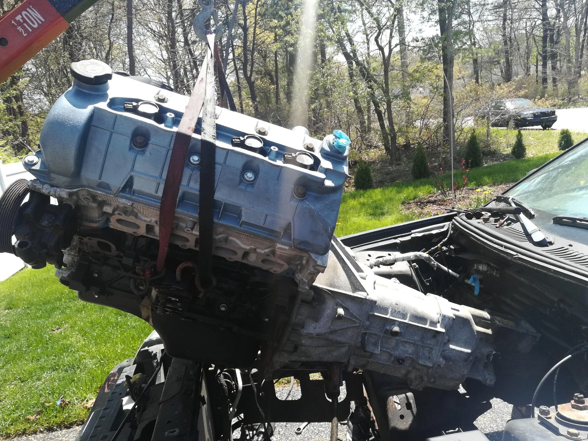

-5.4L SOHC complete from junkyard
-Navigator DOHC heads

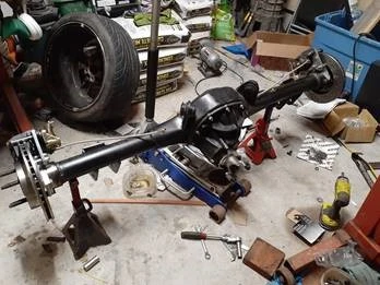

-Custom Ford 9inch
-Ford 9 inch Disk brake kit

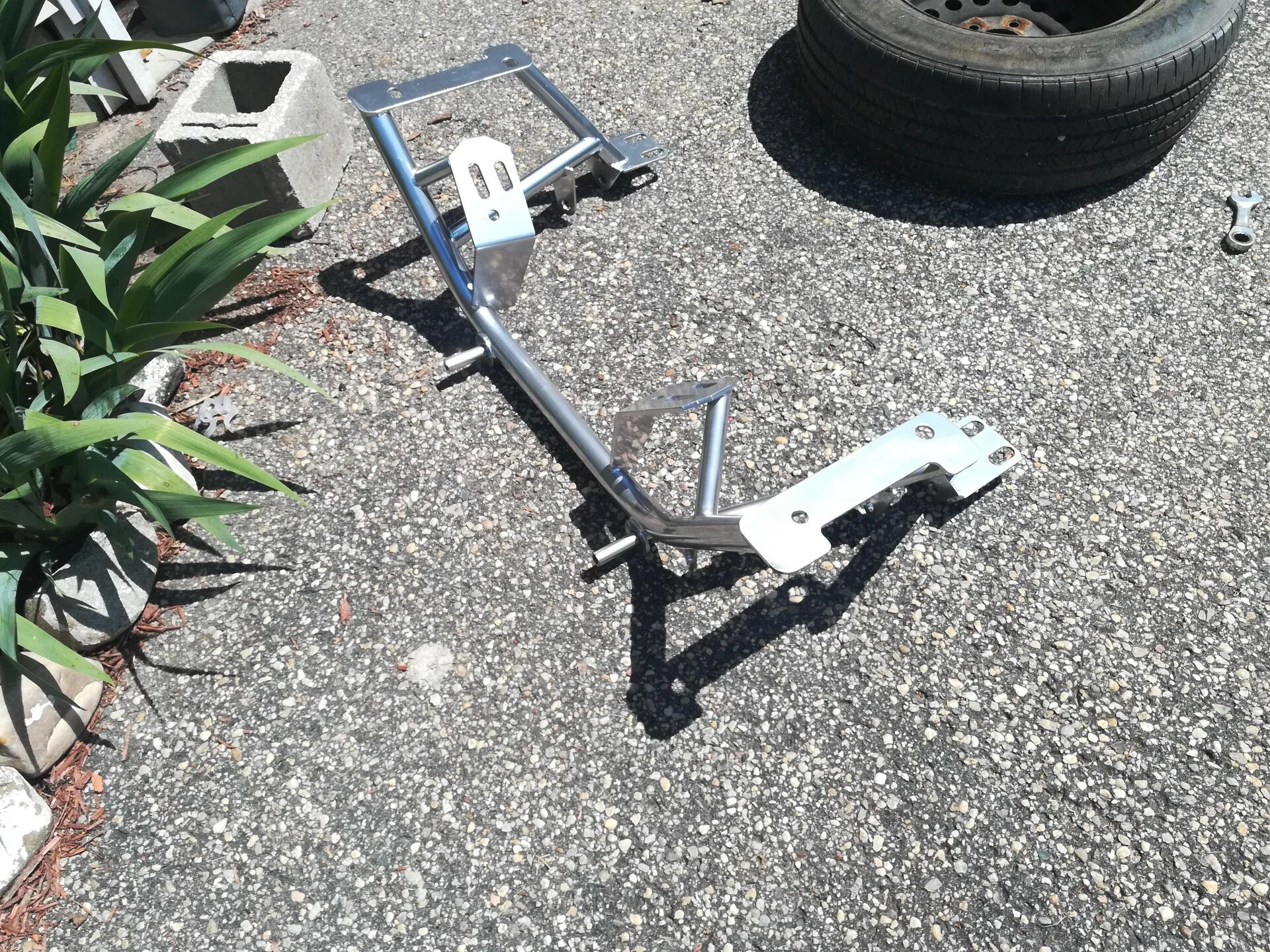

-UPR K-Member

Unfortunately, I do not have pics of when I was building the engine or the Ford 9 inch. But I will certainly document and show pictures of twin turbo install when I start that phase of the project.
