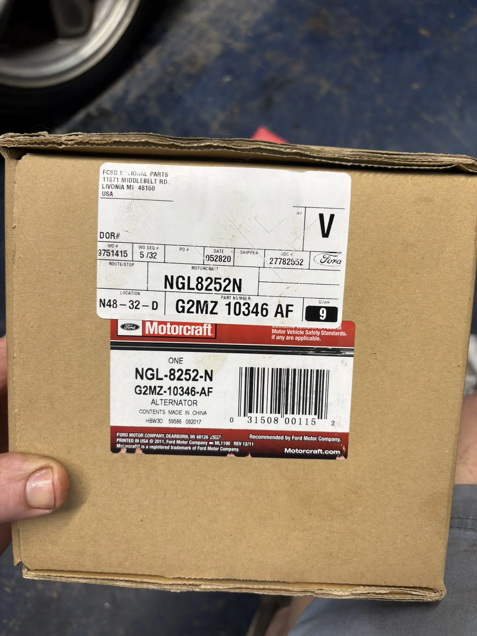

So with new tensioner, new idler pulleys, belt and water pump - the OEM Motorcraft alternator bearings felt a bit 'draggy'. Not a fan of aftermarket for alternators, so I normally just order rebuild kits. Chasing down the bearing part #s, regulator etc - randomly ran across a NOS new in the box Motorcraft NEW (not reman) alternator for $100+ the ride. Couldn't pass that up. Hell, junkyard wants $40 for one that might or might not work. I'll install the new and rebuild the original and paint the case while I'm at it. Rebuild kit is only $60 for brushes, regulator, bearings, retainer and cover.
I also noticed how nasty the power steering fluid looked (Hydroboost car of course) so I sucked some out, replaced some etc. Might have pulled a bit too much out and got a bit of air in the system. Slight noise. I'll swap some more out one night after work or this weekend, put the front up and do the tried and true 20 turns lock to lock, check fluid, rinse repeat etc.

New alternator came in - got it in installed. Inside one box was the original, unopened (paper shipping tape under original label) Motorcraft NEW 4.6 2v alternator. Seller immediately listed another after I bought this one. Have a feeling he cleared out a parts store / dealer. Even had the spec / test and warranty sheet / warning in the box. I'll rebuild the original and paint the case.

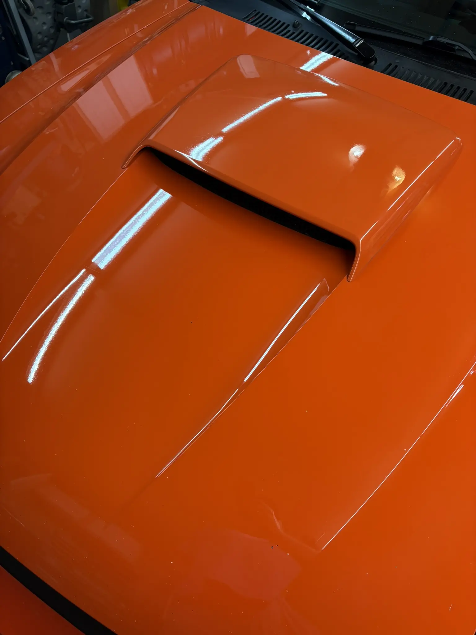

Storming outside - cleaning up the shop and decided to do a quick and dirty cut / polish on the 20+ year old hood paint. Tried out some new spray on ceramic coating my buddies have been raving about. Made by cerakote.
Quick cut with heavy, then fine, then a wipe on / wipe off w/ this cerakote stuff
You can see the chips etc - daily driven - 22 year old paint. Not bad though for minimal effort

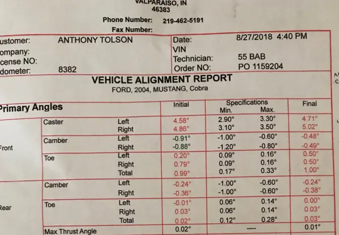

My '04 is my daily - so a few days ago I notice a noise. Not really "a" noise. Just more of a different 'sound' of the car driving down the road.
It's not a noise where I'm worried about something breaking - it's just that the car started to make a different sound when driving. It's road noise for sure - it differs based on various roads / surfaces etc.
Truth is, I'm sure most people would never notice it. That's fine. Seemed to be most noticeable with the window down coming from the LH wheel / tire. No vibration, no pulling etc - like I said - the road noise from the car was just 'different'. Jacked it up spun the wheel / tire wanted to make sure no bearing noises. Both LCAs, ball joints, tie rods (inner and outer), struts etc - I've already replaced. The only mechanical thing (besides a new part failure - hey it does happen) could be the hub / front wheel bearing.
No play. No noise. Granted they have @ 100K on 'em so wouldn't be a bad idea regardless - but no play / real 'roar' or noise from them.
I wondered if my quick and dirty setting of toe in (after springs / control arms, tie rods etc) was coming back to bite me.
That would be yes. I've got some inner tire wear - not horrible noticeable visually - but I can feel it running my hand across it. I have no one to blame but me - I should have measured camber etc but I did not.
NOTE: The car does not have CC plates and it had Eibach Pro Kit springs on it (since close to when it was new) when I bought it and no weird tire wear. I've since:

Toe in is usually inner wear. Toe out is outer wear. It's due to the caster angle that these cars are set with. The tops of the struts are raked back so when the wheels tilt in, they kinda roll over the edge of the tire a little bit.

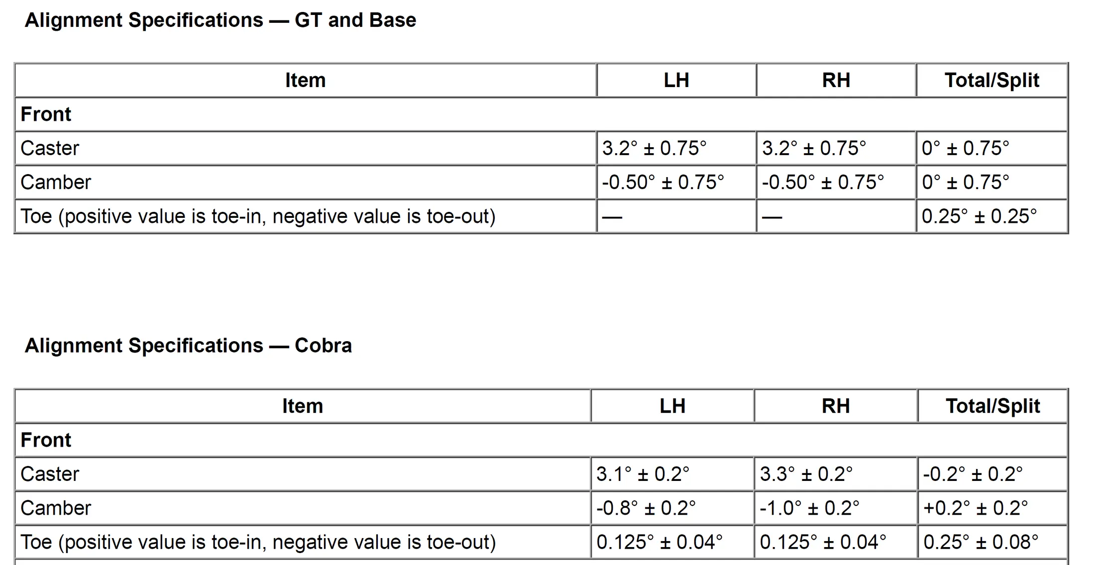

ctandc said:
Think 1/8 TOTAL Toe in is too much?
It's at the upper end of the range. 1/8" total toe in is about 28 degrees total with a 245/45/17. 1/16" is about 18 degrees total toe. I guess the question is how much deflection do you expect in your rubber control arm bushings? The tighter they are, the less toe in.
This is for a 2004 cobra, but should be close. looks like 28 degrees is your max recommended limit

Mine is set at .11 and .12 toe on each side. Which is about max I'd want to run. maybe .10 total if you want something super responsive.
.50 per side that you have is a clear indication of your inner tire wear.

Per the OEM service manual
