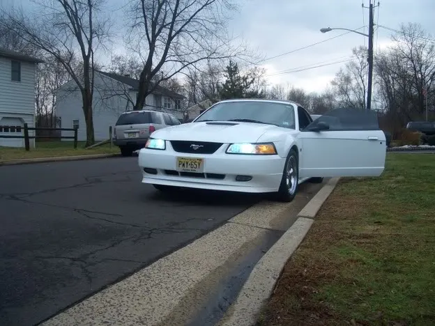

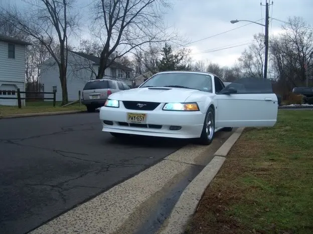

I love my kit. EVERY person who has driven in front of me and past me said they did NOT blind them by any means and drew a lot of attention to the car. I wouldn't replace them for anything.
*god my car looks like crap here. Old GT hood and stock 00 headlamps. YUCK! ahaha*

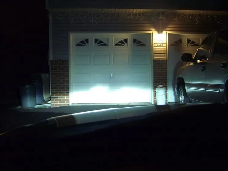

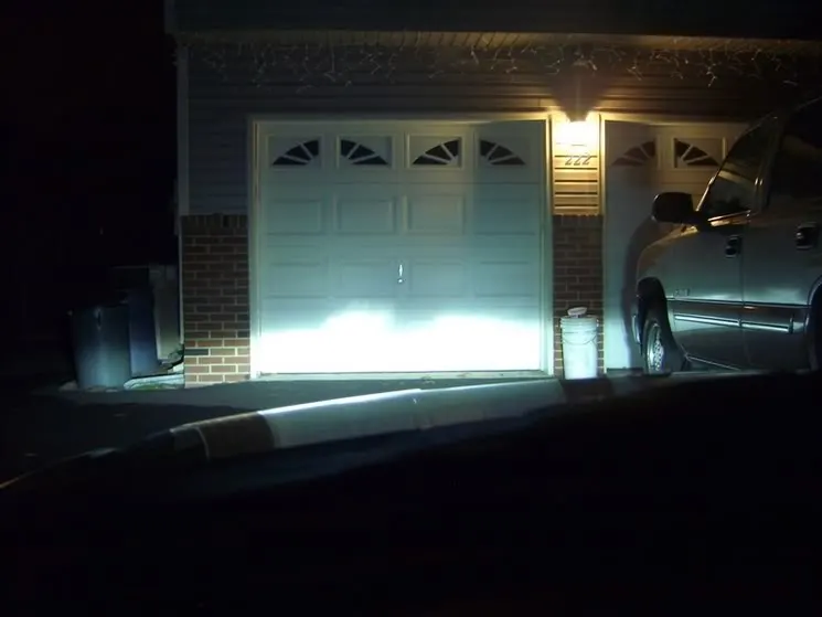

As for these pictures of the cutoff. Taking the shot 10 feet away against a garage isn't gonna tell you much unless cars drive 10 feet away from you. You really need to shoot your lights against the side of a building 100 feet or more away and see how the light spreads on that
