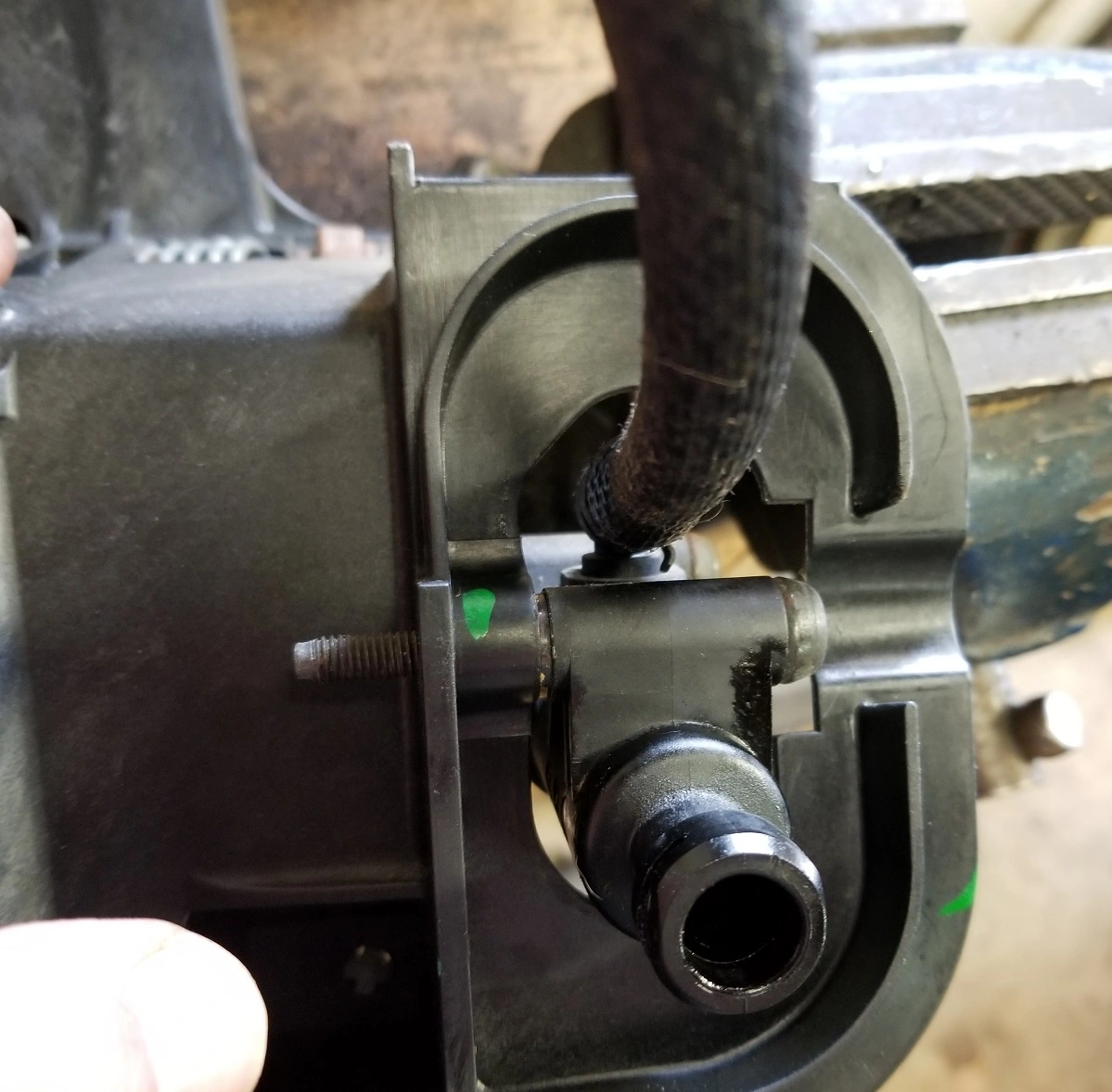

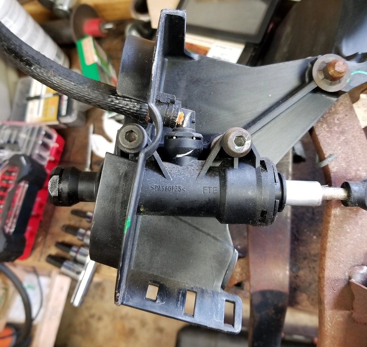

I took these pics of the assembly out of the car. The master cylinder bolts take a 5mm allen bit, the rear bolt has a threaded insert but the front one has a 10mm locknut on it. No idea why they did it this way. I'd say either way of doing it is probably equally difficult. The pedal assembly is only held in by 4 nuts (on the back of the brake booster) and 2 bolts up under the dash, with about 5 sensors to remove. I used the opportunity while the assembly was out to lube the clutch pedal pivot because mine always squeaked when I pushed in the clutch.
Also there is a wire clip in the end of the master cylinder where the clutch line attaches. You have to remove it to remove the clutch line (easiest done with a pick) and be careful not to lose it. The new master cylinder comes with a new one but it's easy to drop it when you're trying to put it back in after you reinstall the clutch line.
