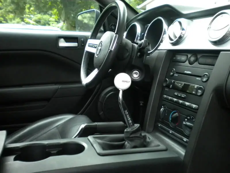

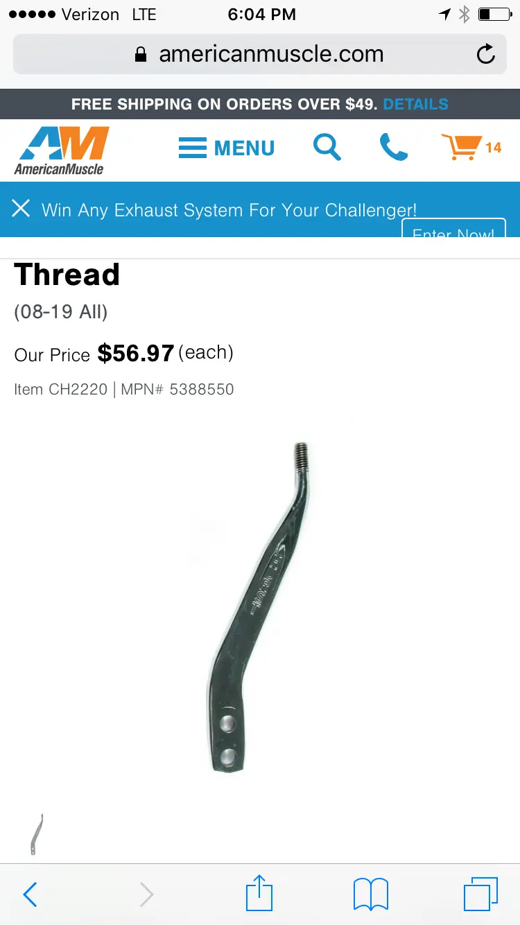

I have looked but I can't find an answer to this. Can anyone tell me why this angled back shifter stick would or wouldn't work on the hurst short throw shifter kit for the TR3650 trans in the 05-10 GTs? From what I read the sticks are two bolt universal. I'm used to 04 and older models with this design and wanted to go back to the feel. Thanks

It'll work, I used to have that same stick on my old Hurst. It just fits kinda weird because the serrations to line up with the piece on the shifter ball itself are on the wrong side and I believe the holes are bigger, but if you tighten it down good it'll be fine (on mine I used longer bolts and put another nut on the other side of the shifter to make sure it wouldn't come loose). Be aware that's a long stick, but on my Hurst I really liked it as the Hurst has super short throws, and it looked pretty cool. I even used a Hurst stick on my Tri-Ax that I have now (had to get a shorter one, that one was too long).
