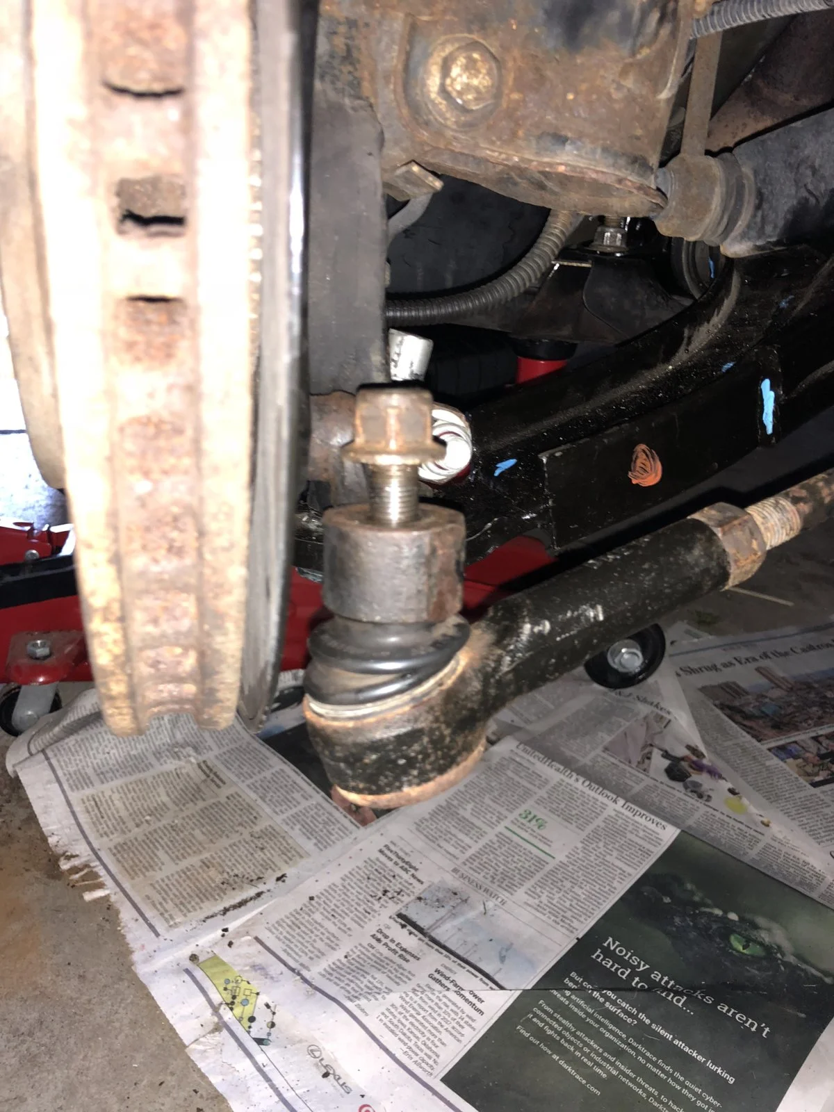

Ha. Funny you should mention that. I ended up doing just that. Took the tie rod ends off the spindle. Control arms are now in, but now I created a new problem. Tie rods won’t go back in. When i go to spin the nut, the bolt spins with. Tried c clamping it, loaded it with the floor jack...no luck.

That's always a problem. I can't remember- is there a hex on the head of the tie rod end stud? Or, do you have access to an impact to see if you can zip it on there?
You may just have to figure out some way to put a load on it to bind the stud a little- maybe jack up from the bottom of the control arm and turn the wheel a little, I'm not sure what's the best way to do that. I suppose if all else fails maybe a little loctite inside the tie rod end can help hold it in place to get the nut on.
Tried the impact wrench. No such luck. The thing spins freely no matter what. I even loaded it with the floor jack underneath the actual tie rod. No luck. If I can just get the nut threaded down enough to expose the top of the stud then I can take a second 12 point box wrench and double wrench it. One on the stud and another on the bolt. As of right now I can’t get that far even. Just fishing in the dark at this point!
