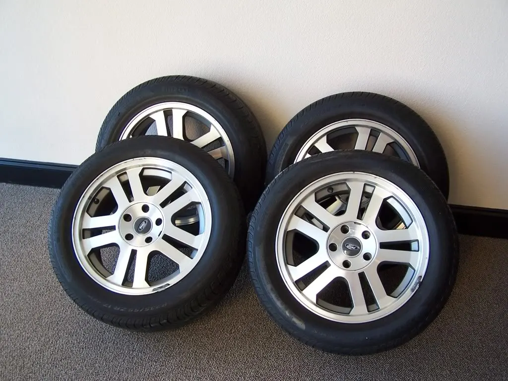

You'll need 1.5" or maybe 1.25" (depends on the upper control arm) bolt on spacers to run any wheels from an 05 or newer Stang on a 66. I had a set of 05 premium Gt wheels on my 66 for a few months with 225/45's up front and 245/45's out back, with 1.25" spacers up front and 1.5" out back (slightly narrower that stock rear). I switched to 02 Bullitts later on. Pic of the wheels attached.

I had a set of '05 16" v6 wheels I was gonna run on my car, and yes, the offset is off the map! You will have to run 1.5" spacers. Not a good idea. That moves your leverage point on the suspension out too far and it induces too much stress on the shock towers, and they will start to crack. I ended up selling mine and am going to have to go with a different wheel.
