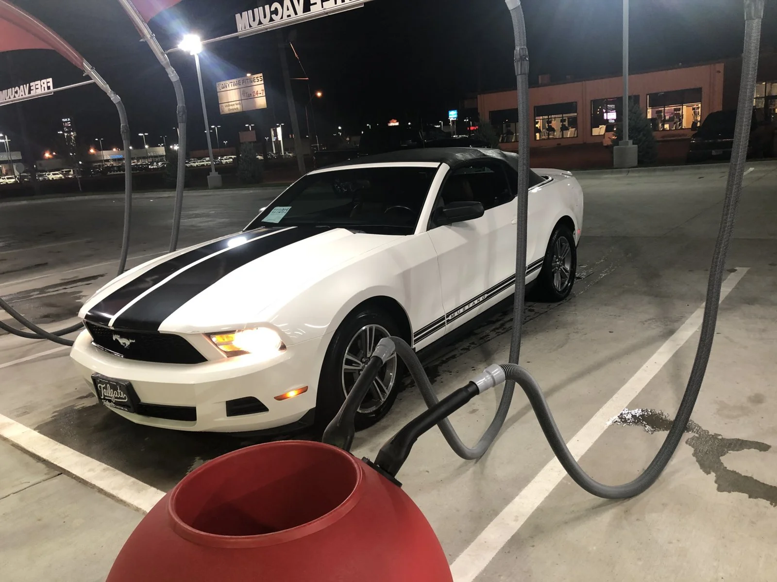

Alright guys. Talk time. I’ve had a 2010 v6 for a few months now. Word got around my family, and my uncle has a 302 engine out of a 99 explorer. Would this fit? K member? Ecu? Transmission would bolt right up with the pattern. Engine mounts would have to change. Any help would be great guys!
No I don’t want to sell the mustang and get a boss 302 or a gt. I want something different than what everyone else has. Money isn’t a problem with this build.

Well...I am not sure how useful this is, but the 3.7L fits the S197 chassis...and that engine is almost exactly the same physical size(width and height) as a 351w(and a 351w is both taller and wider slightly than a 302). So in short...I am sure with a rear-sump oil pan the engine will physically fit
