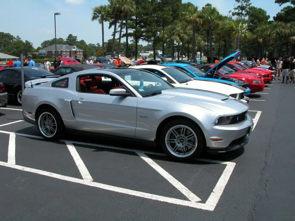

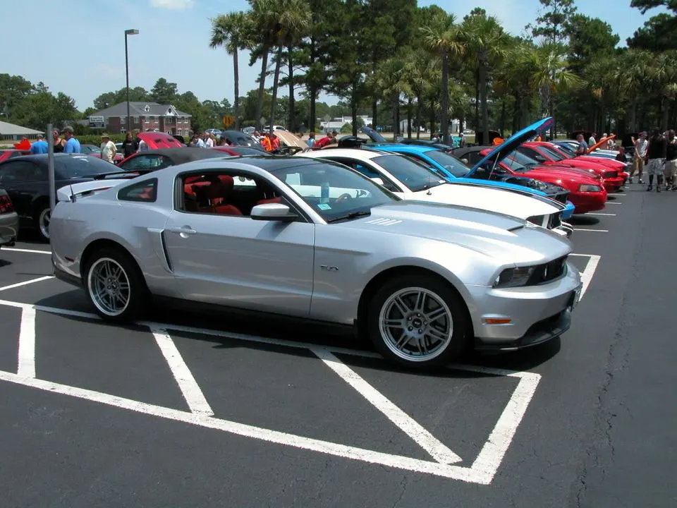

Brembo
Man am I glad I ordered my 14" Brembos from the factory. It was a great deal for $1600 bucks, brakes front and rear, Tower brace and 19" wheels. I believe the traction control and stability control is also modified for the Brembos.
I really like the way the rotor fills the wheel.
