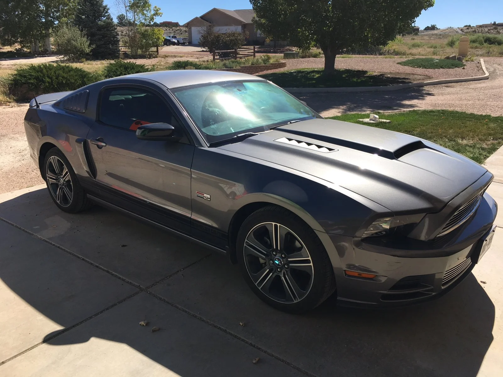

I have a 2014 V6 Mustang with an A/T and the optional Performance Package, which includes a 3.31 final gear ratio. To this point, the only "performance" mods which I've made are the installation of an Airaid MXP CAI, a BBK 3.7L V6 73mm Power Plus throttle body, and a Bama 91-octane tune.
About a year ago, I purchased the parts needed for a gear change to 3.73 final gear ratio, but have stalled on installing due to indecision. Coming to the conclusion that I don't need an off-the-line rocket, I'm concerned that the 3.73 might be a bit too tall. My dilemma at this point is whether to: 1) sell the 3.73 ring/pinion gear; keeping the rest of the installation componets (install kit & pinion bearing) and instead buy/go with a middle-of-the-road 3.55 gear set; 2) keep/install the 3.73s that I currently have on hand; or 3) junk the whole idea and just stick w/ the 3.31s that are already installed.

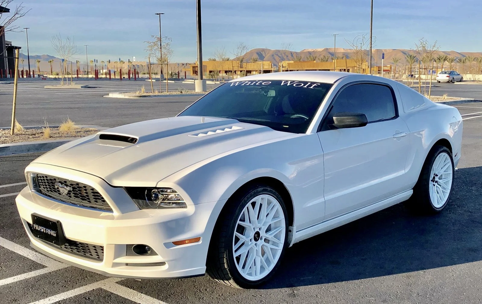

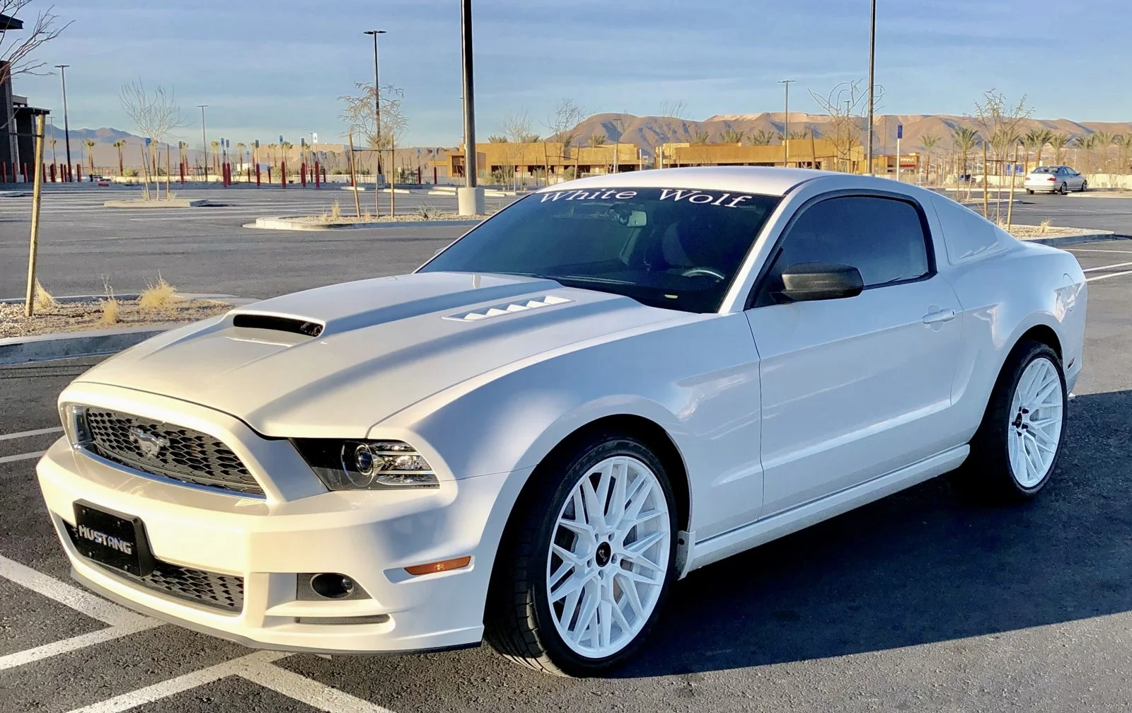

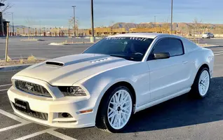

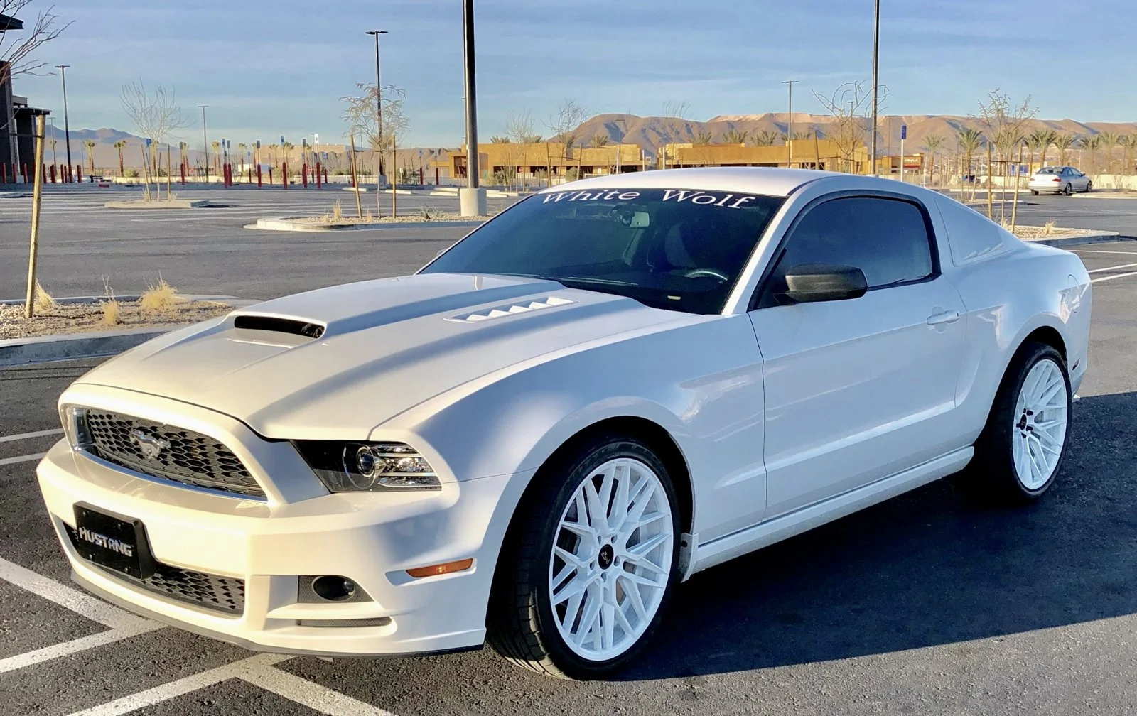

Gearing on my 2013 Automatic V6 (White Wolf) was the first Mod I changed after the CAI. I chose 4:10 and can tell you they are awesome. On the highway I run about 2700 rpm at 70mph. This is a City Vegas car though and 99% of the time it never hits the highway and only tops out at 50mph on any city road around here. I love them and could not imagine the car again with stock gears. 305's in the rear are the perfect tire size. I now have every Mod you can put on it except a NEW TORQUE CONVERTER which I just ordered from Circle D. It will be a 3800 Stall plus a new Aluminum Driveshaft and Upper and Lower Control Arms. This V6 can easily out run stock or lightly modified V8 in town. Thats not talk, I have done it on numerous occasions.

Looks like we've done a few of the same exterior mods... What else ya runnin'?

My mods are CAI, Long Tube Headers, X Pipe, Cat Back Competition Magnaflow Mufflers, BBK 73mm Throttle Body, 4:10 Gears with NEW TRACTION LOK Carbon Discs which I highly recommend if your going to go in there anyway. Staggered Tire set up Nitto NT555 G2 FRONT: 255-35R-20 REAR: 305-30R-20. Torque Converter 3800 Stall, Aluminum Driveshaft, Upper Lower Control Arms. Come April 1st I am installing a NEW NX Nitrous Plate System on a Progressive Controller 125 Shot to round it out. That will complete the car for me and hopefully I can keep it in one piece. Lol
