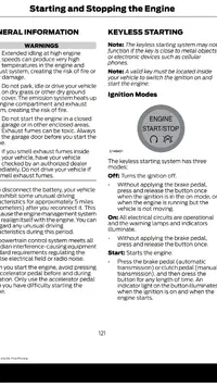

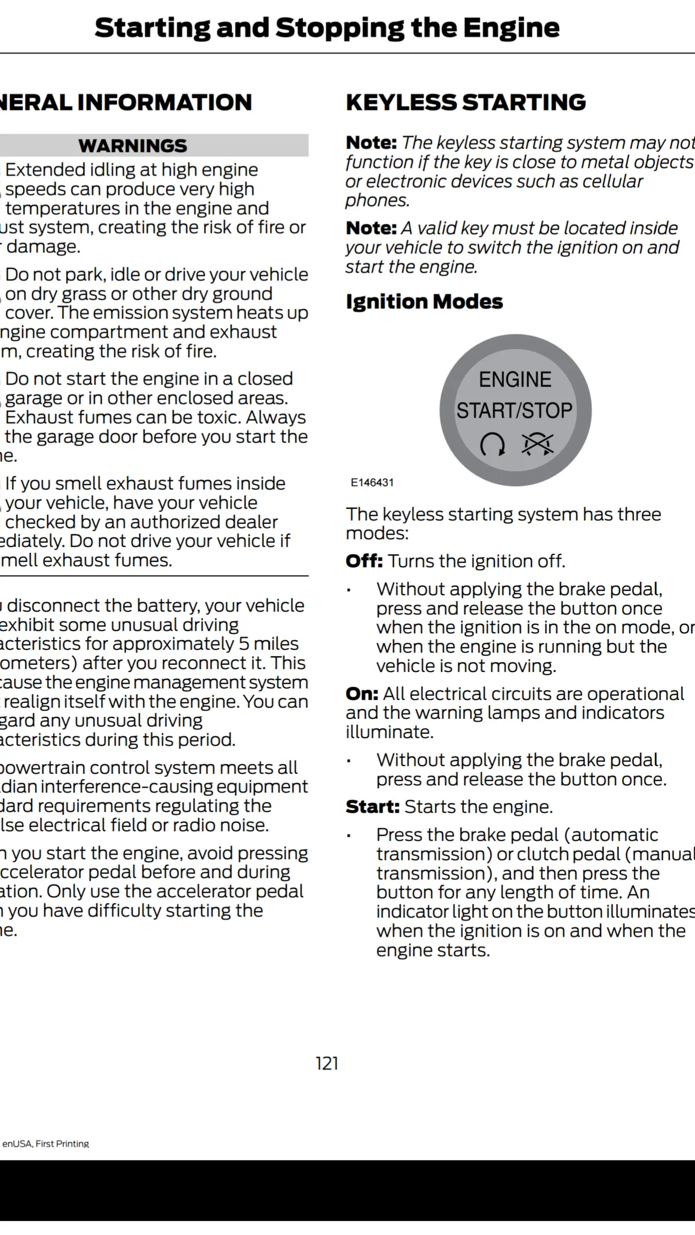

@camguy11
It looks like the owners manual has your solution. The "on" position is achieved by pressing the start/stop button without depressing the brake pedal.
