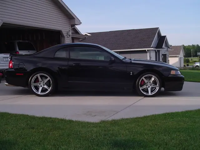

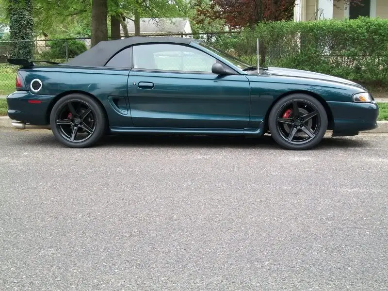

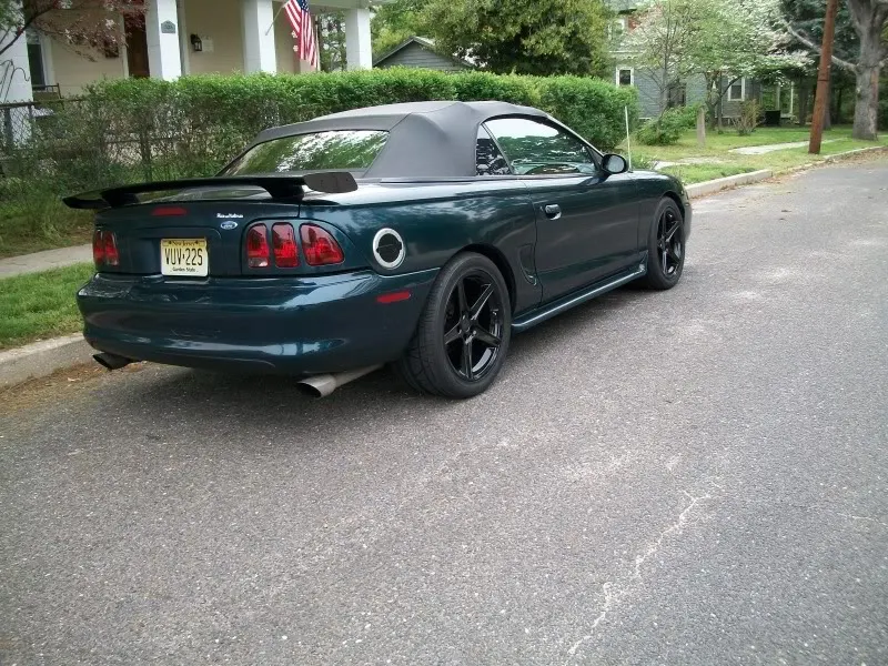

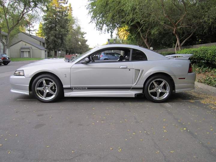

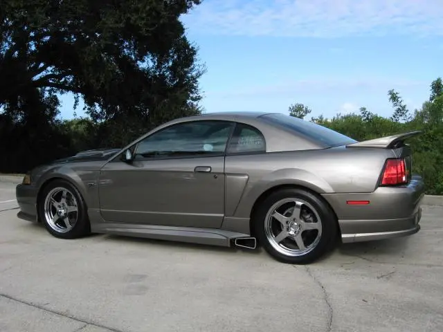

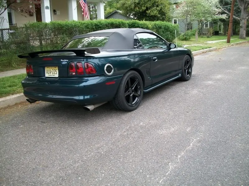

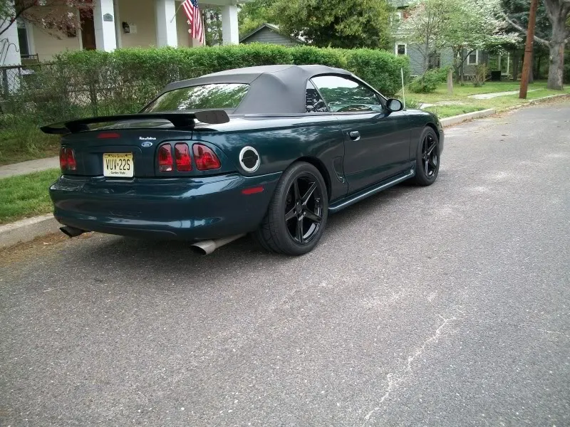

i found some pics that I figured I'd post up for people. If anyone finds more please post. I spent hours on google just to find these. The cars look good too.
275/40/18 all the way around

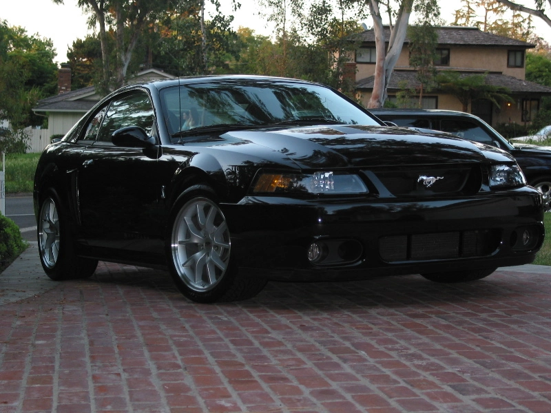

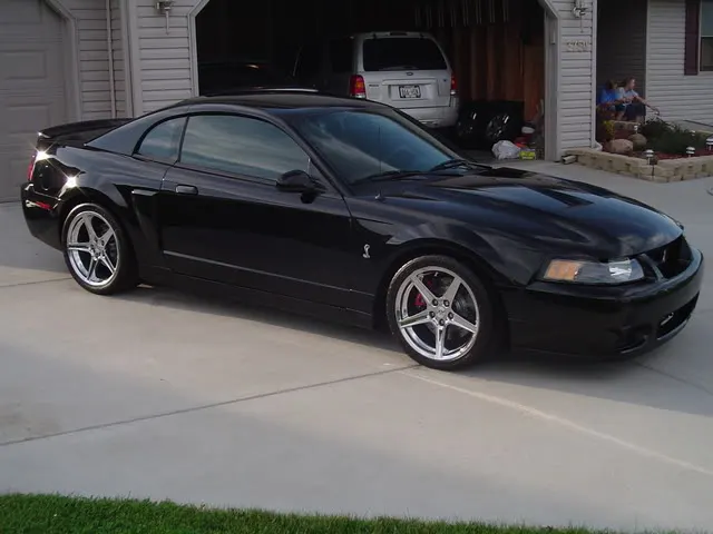

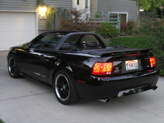

Front: 18x9; 275-35/18
Rear: 18x10; 285-40/18

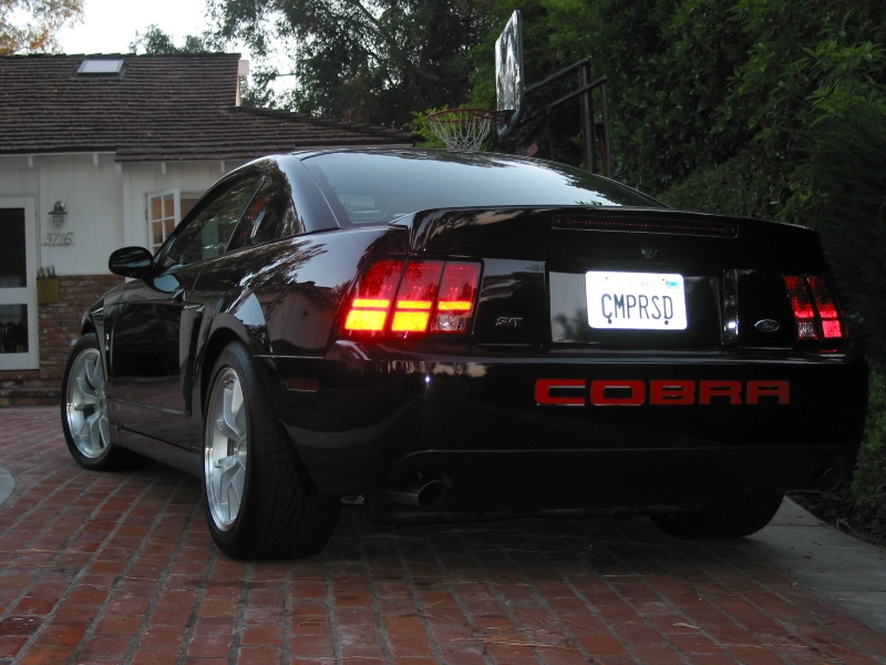

Well....yeah. Since this isn't the S197 forum I figured you wanted to see them on SN95 or new edge cars :shrug:
Yeah I did. Your original post just said on any mustang which is why i asked that question to double check. Not everyone knows the s197's have 40s up front. Ford decided to give the car a little more sidewall for some reason or another.
Just sayin.. That 40 isn't a unit of measurement like the width of the tire. It represents the percentage of the width of the tire that the sidewall is. So on a 275/40, the sidewall is 40% of 275 mm and thus different than the 235/40 that Ford later put on the 05+.
ANYWAYS..I think the pics you have posted of the 275/40's look fine.

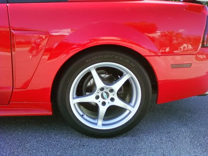

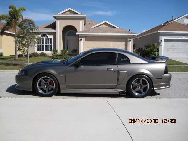

What size wheels are you running? If you have an aftermarket set that are wider than the stock 8" then why not get a little more tire under the rear?

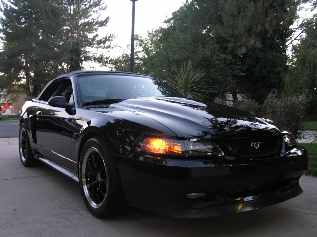

I'm running a 295/40/18 on the rear and 255/45/18 on front.

Your car looks good. I like how the tires fill up the gap. I would but I only have 9 in rims, so I figured I'd keep it 275 all the way around like i have now. It also lets me rotate which is helpful.

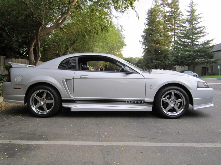

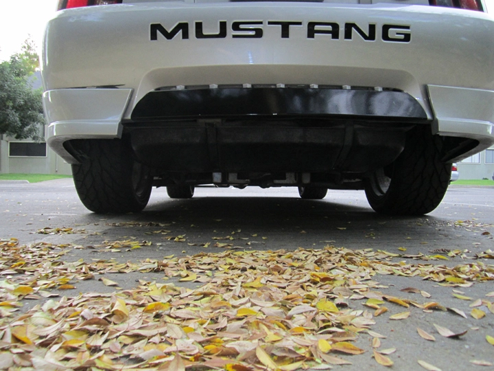

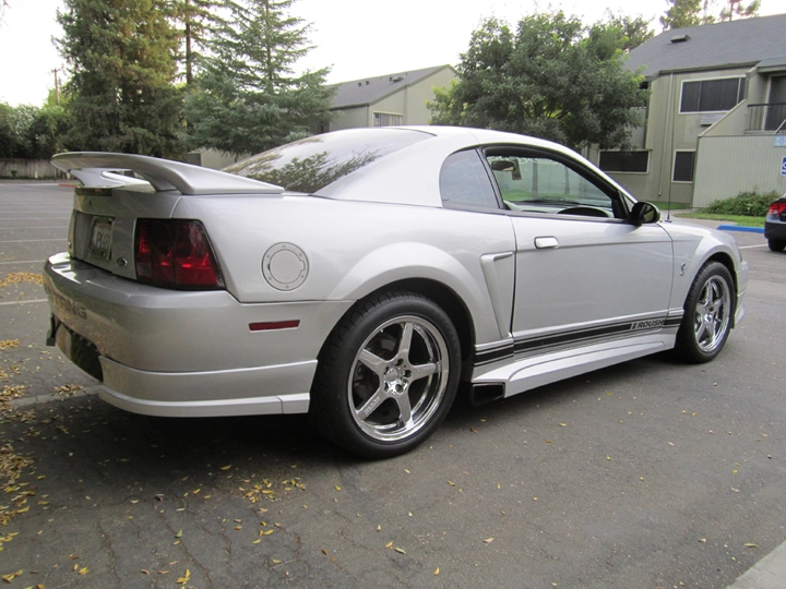

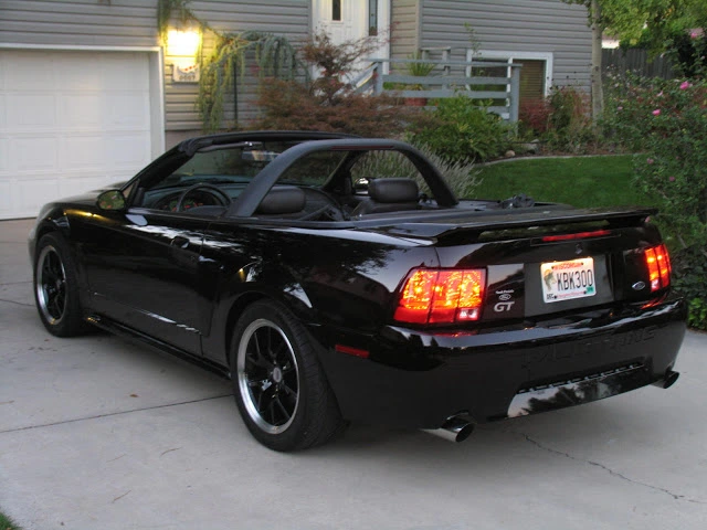

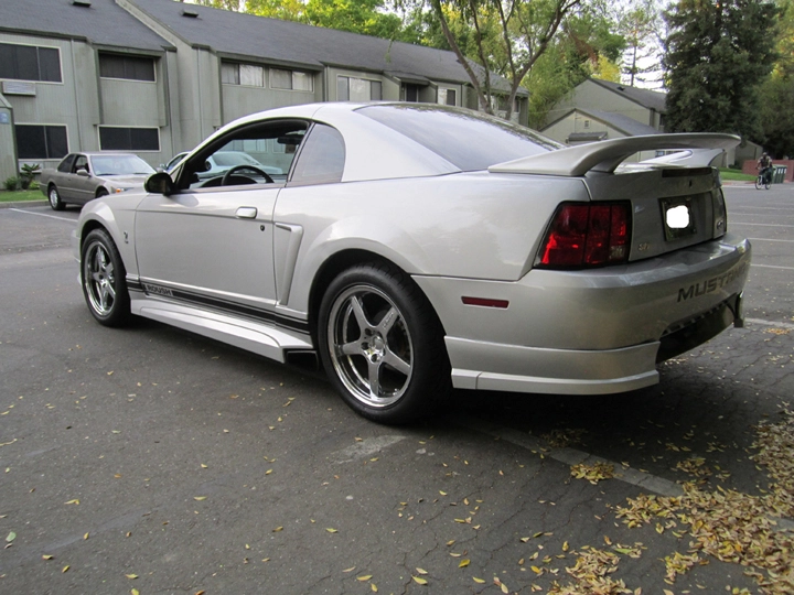

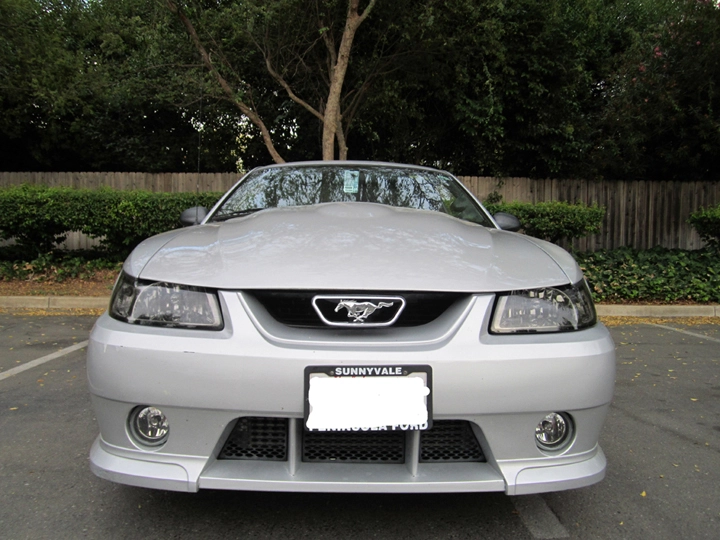

275.40.18 on 18x9 on all 4 corners, its not a bad size. I'm now running 295/35/18 and 275/35/18 and I need to go lower, looking to swap my Eibach Pro-kit for some H&R SS.
Sweet looking car! I want that hood! I'm actually buying that hood very soon cant wait.
If i went with a bigger tire such as a 295 or 315 I would have gone with a 35 ratio for sure. Since I'm limited by my 9 in rim I plan on keeping it at 275. I'd rather not have any side bulging and such.
