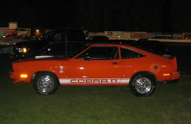

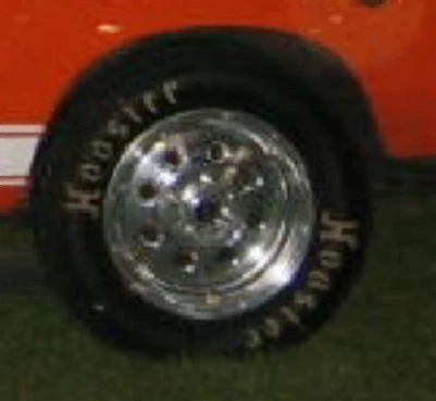

http://www.starshadow.com/~gael/pics/mustangii/rearwheels/ :D
It looks like it should fit, it's REALLY close to everything. I haven't test driven it, it'll still be a while till it's on the road. Gotta finish the drivetrain install, put the intake back on, fix the valve cover, put the nitrous stuff in, and maybe relocate the radiator a bit to fit the MK VIII fan.
From what I can tell though, it fits. Also though, I trimmed the inner fender pretty much completely.
15x8 Weld Draglites with 4.5" backspacing seems to be ideal for our rear tires. If you aren't so keen on doing what I did, I think 255/60/15 would fit with unmodified fenders with the 15x8 4.5" backspace wheels.
Looks got but IMO never mind how wide...it`s how sticky I worry about!What kind of tire do you have on ? It looks like T/A`s by the thread pattern.Draglites look great on a II :nice: Good choice! :D

Nice work Gael.
You can fit a BIG tire under there, with the right combo and work. I have an 11.5" tire under the back of the Thundersnake. I had to trim the fender lip and also hammer the "bump" back in on the inner fender. I had custom rims made to my specs for size and offset and I had to find just the right tire to make it all work. But in the end, I've still got an 11.5" tire on there and I don't think anyone else has done that yet :D.

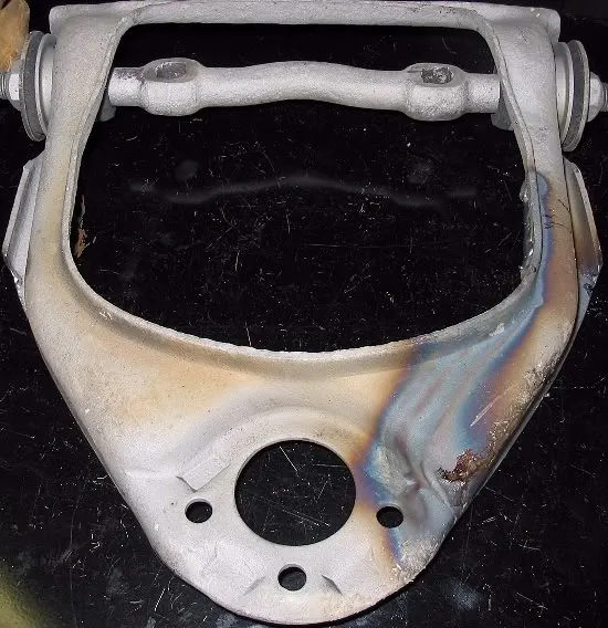

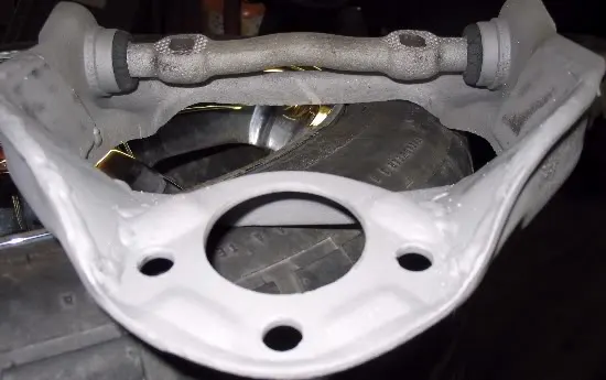

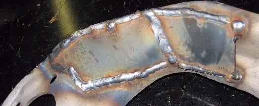

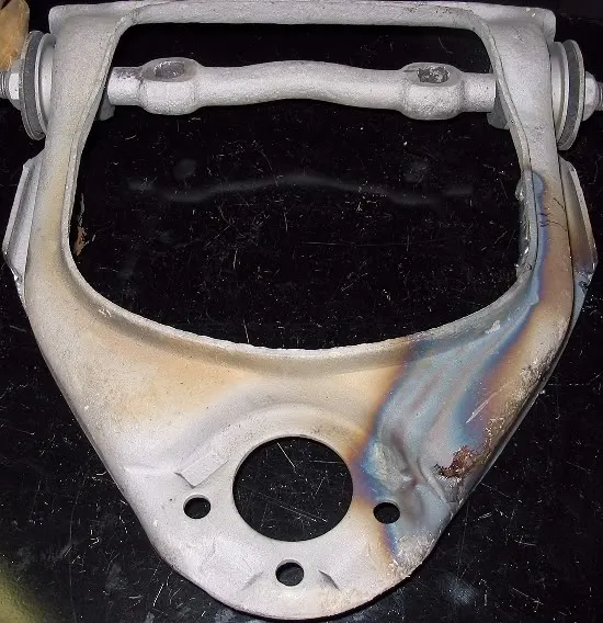

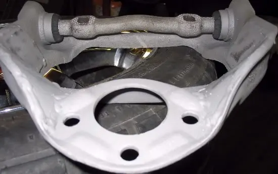

As for the front end, I trimmed the outer reinforcing lip from the upper control arms and then welded in steel to box the arms for strength.
I left the lip on the rear of the arms, since the inside edge of the rim will never contact that area.
With that lip gone from both sides, the wheels have a lot more steering travel.

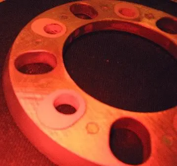

I pressed in some 3-inch-long ARP wheel studs, because I needed to install 7/16" wheel spacers to give me even more steering travel, and I wanted the added strength of the heavy duty parts. I could have spent a few hundred dollars on billet alum. spacers that would fit perfectly on the rotors, but money was tight at the time, so I ordered up some cheap ones for the time being.(they're still on there)

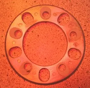

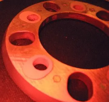

The cheap wheel spacers are "universal fit", in other words, they suck. They just flopped around on the rotor, without being centered at all, since the slotted holes were too big. So I fabricated a 5-lug jig to hold them in place and then I cast plastic inserts for the spacers, which would perfectly center them on the rotors.
I also fabricated some adjustable steering limiters and installed them onto the strut rods, so once I had them adjusted properly, the tires never touch any part of the car.

Anyway, the overall effect is that the car steers tighter after mods with the 245/45ZR17s on the front than it used to with the 195/70R13s before mods. Next year, hopefully I will be installing 3" fender flares, so I can get a much wider tire on the car. (Shooting for 335/40ZR17)
