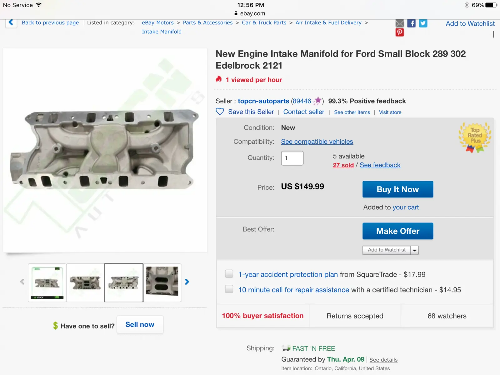

Picked up an Autolite 4100 C5Z I'm great shape. It came with the plate with the vacuum port. Now I need to a decision on an intake manifold to match it. This one says Edelbrock 2121 "match" but are these cheapo's? Anyone have any insight on these?
That's a Chinese knock-off that looks like a cross between an Edelbrock 2121 and a 7121.
For the whopping $25 more, I'd rather buy the used genuine Edelbrock manifold listed on Ebay and know what I'm getting.
EDELBROCK 2121 PERFORMER 289 MANIFOLD--260-289-302-Small Block Ford | eBay
EDELBROCK 2121 PERFORMER 289 MANIFOLD--260-289-302-Small Block Ford . Condition is Used. Shipped with Standard Shipping.
rover.ebay.com
That Chinese manifold could work just fine, but if its flow characteristics are more like the 7121 (which is the Performer RPM) than the 2121 (which is the Performer 289), you're probably going to kill your low end torque and driveability on a stock 289.

W
Waynedoggie
Mar 28, 2020
11
Newport Beach, CA
Apr 6, 2020
#11
  • Apr 6, 2020
  • #11
rover.ebay.com
I'm still a little confused. Which one would be best for low end torque and drive Ability?
Adieu
Easy there, this ain't a dating site.
20+ Year Stangneter
Mar 7, 2002
9,531
5,187
224
Apr 6, 2020
#12
  • Apr 6, 2020
  • #12
Edelbrock Performer 289

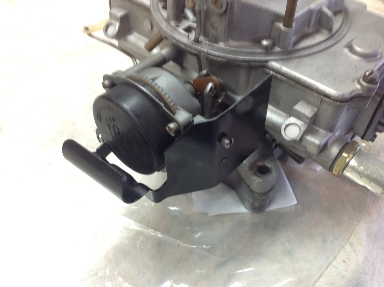

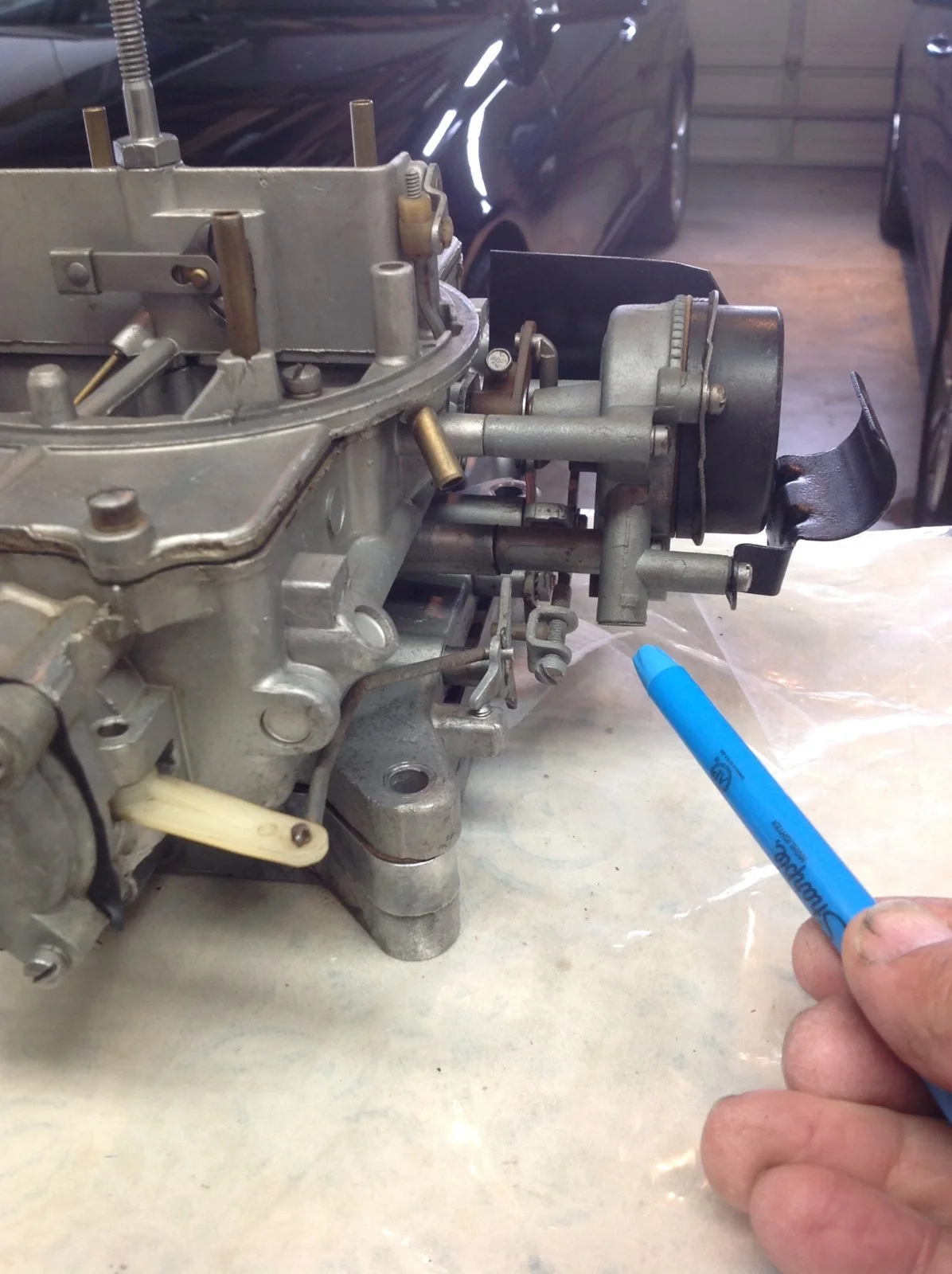

Waynedoggie said:
Yes, that’s a good one, so with my new 4100 it is an auto choke, and my standard exhaust manifolds have the integrated choke pipe in the right side mani to feed the Autolite (had this set up on my 2100). The HiPo 4100 was a manual choke with no choke pipe on the HiPo exhaust manifold, so I guess I’m answering my own question. I need the choke pipe for the Autolite auto choke, so I can’t convert to the HiPo exhaust manifolds. Any other performance exhaust manifolds with the choke pipe that will fit that you know of?
Can you post a pic of your 4100?

Ok, back to it. I've got the 1.08 Autolite 4100 with the auto choke from the exhaust manifold tubes. Same as my 2100 I just took off. The tube would go into the coil at the same spot from the stock 289 exhaust manifold. If I really wanted the HiPo exh manifolds I would have two choices - actually three. 1) convert auto choke to electric. 2) strap on a dorman converter to the new manifolds (but not sure this would work on cast iron HiPo manifolds....not get hot enough quick enough like shorty' would), or 3) go old school with a manual choke. I live in Newport Beach, CA where it's always between 55 and 75 degrees. What's the best choice? I'm thing #1 cause my wife will drive it and leave the manual choke pulled out!
Ps, what's that black metal piece around the choke mechanism? Heat shield?

I've done the manual choke conversion before, it' not the best, but it works, and as mild as your climate is, it could be a good option.
Dorman's choke stove is an option as well, I haven't used it personally. Usually Dorman's products work.
I haven't converted to electric choke before, but with the similarities between the 4100 and a Holley, it shouldn't be too difficult. This would personally be my first choice because I like electric chokes on carburetors.

The black metal piece around the choke mechanism is the choke shield.
ttps://www.cjponyparts.com/carburetor-choke-thermostat-heat-shield-for-autolite-2100-carburetor-2-barrel-289-1965-1968/p/CTHS/
