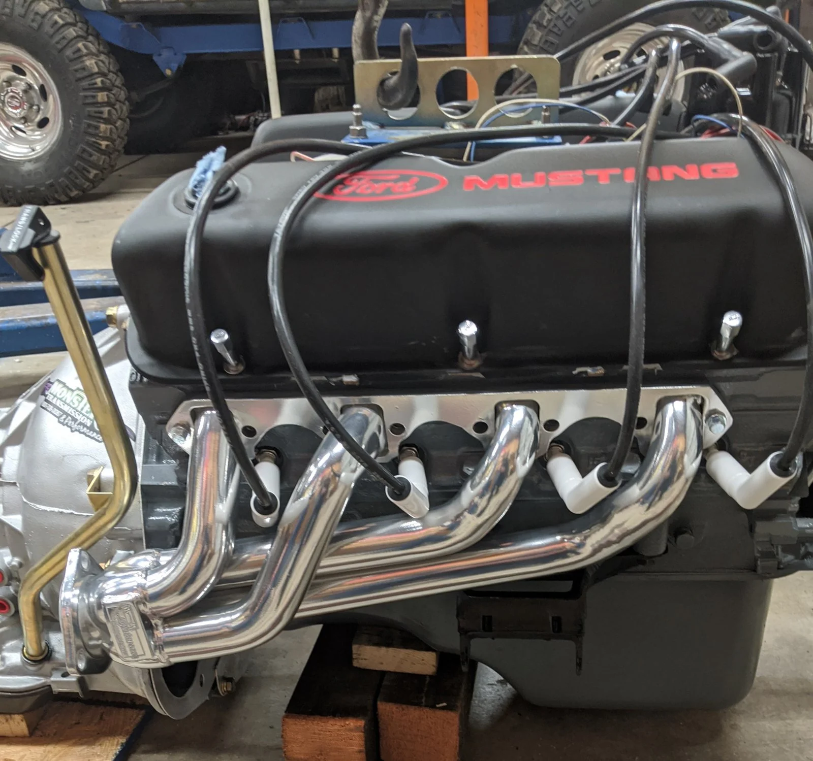

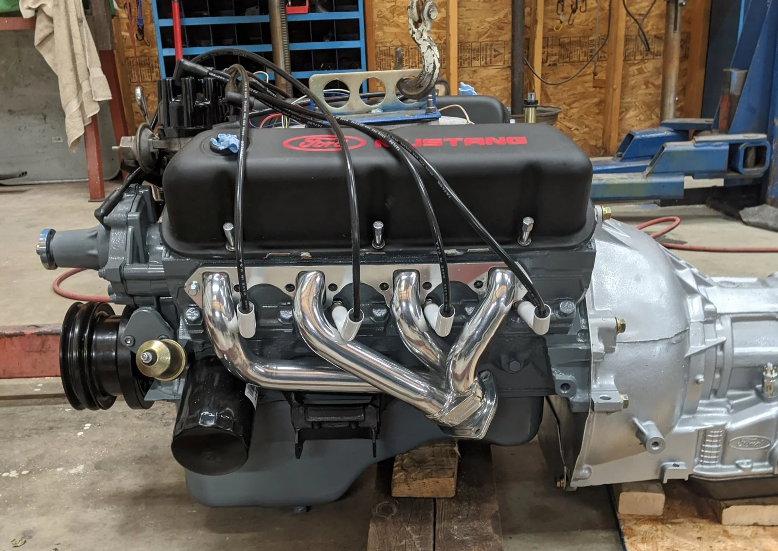

These work,
Sanderson Headers FF3GTS-SEC. See the pictures. The transmission is a AOD. I struggled so much I hope this helps.
