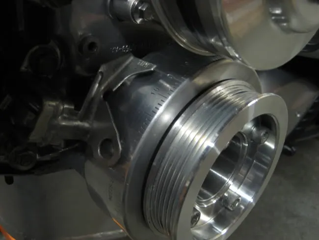

The damper (balancer) is the same from Fox and SN95, but the fox has a deeper crank pulley that bolts to it. The model # of the SFI balancer I have on my '95 is the same model # for a fox.

Sounds like your thinking these have crank trigger iginition....which they dont.
These are old school timing...
