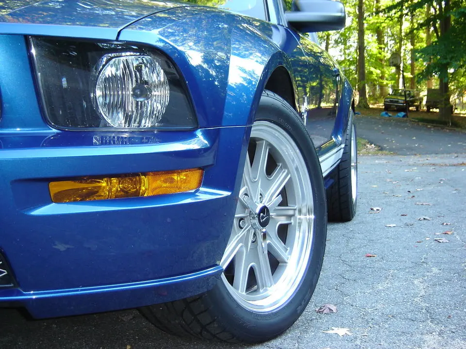

SWEET sounds like a plan here is a pic of the rim ....My car is silver with full black out 5% tint on every window, B2 chin spoiler (awaiting install) smoke lights everywhere they can be applied and H&R super sport awaiting install as well !

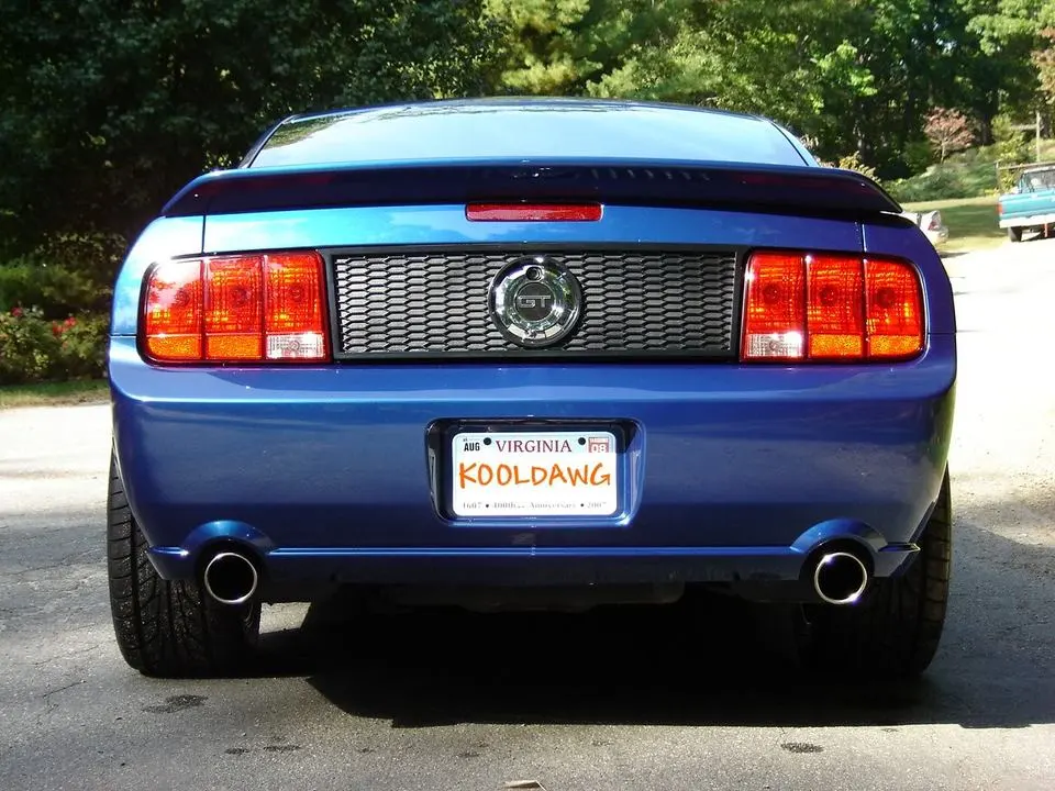

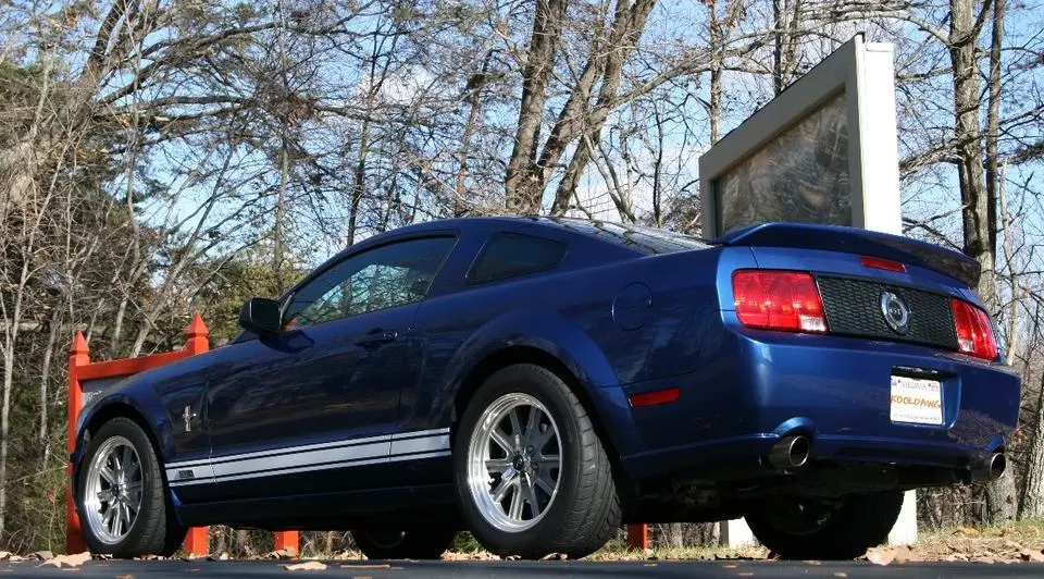

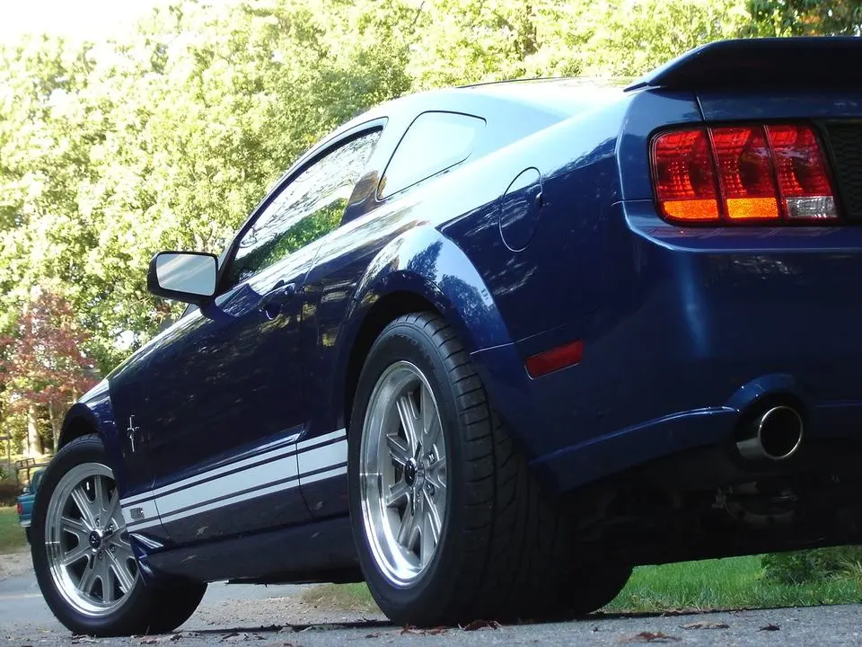

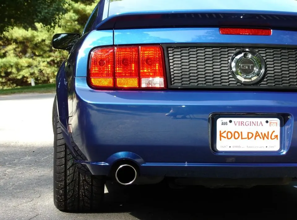

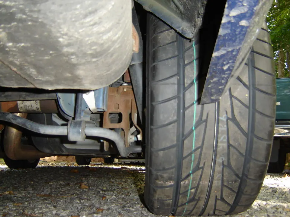

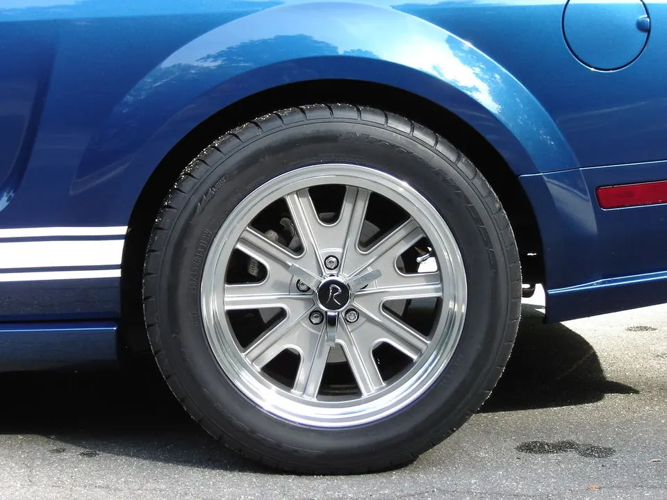

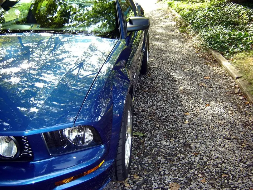

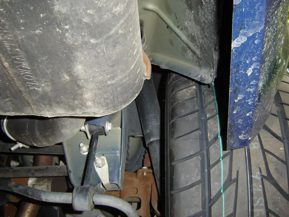

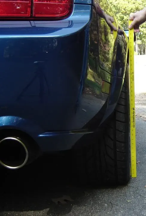

It will fit on the 9" wheel. The thing that bothers me is the actual sidewall height may be too short to allow for enough proper sidewall flex. A taller aspect ratio would be much better suited for the 9". I have a 295/45 on 10" wheel and I don't see why it couldn't be mounted on a 9" wheel.
Got the tires from a local tire shop in town. Not as cheap as a few places on the net, but I've dealt with them for about 15 years and if I have a problem they're less than a mile away:nice:
Do I have picks from the back.....You asked:D
And one from the front
