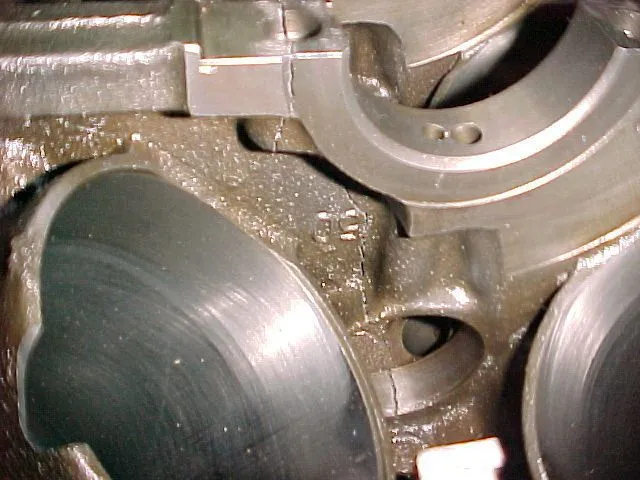

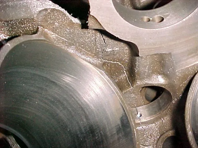

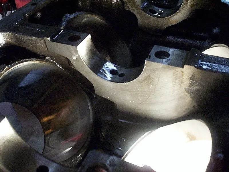

Here's you go... 420 RWHP from a stock block. Notice that the block halves are relatively close to one another. THAT's what the main girdle is good for. Holding the pieces together so that you can possibly reuse the internals. To date, there's no girdle on the market that will beef up the diagnal, torsional stresses that cause them to split down the middle. Now take a look at the attach point pints for your valley girdle and tell me how those are going to prevent the block from twisting laterally. The block were just not designed to handle this kind of horse power. Some folks get lucky... They treat them nice and are careful and they last a few thousand miles. Some are careful and they only last a pass or two. The point is that it's pot luck. An upper, realatively safe limit for a stock 302 block is between 400 and 450 RWHP. Heed the warning and be happy or do't heed the warning and discover the truth of it the hard way. :)
