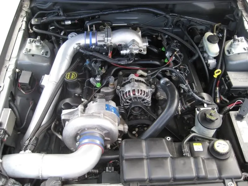

here is a pic of my engine bay for ref:
Anyone have and pics of different combos?
i have the trickflow intake... the alternator does get flipped around but it gives u two mounting locations when u do that... one is for if u have a blower so it should move it a tad to the drivers side to clear... the throttle body is pretty close to factory location... its not a 100% match but very close...
as far the egr and iac... the iac gets moved but it comes with wire leads to extend the factory harness.. also i think the egr gets moved.. I didnt use that part of the kit but if i remember right it has a way of moving that as well...
Trickflow does state u can use the stock cams... but with using a blower and maxing it out u might want to consider using a "blower cam". switching to 4V is better but costs more for other mods as well as having to replace some you have already done and spent money on.. the big problem with the 2v heads is the intake port. part of the valve is shrouded and to fix that you will either need to do "big bore", larger valves with matching pistons, or get the new trickflow heads which say they help with that condition..
