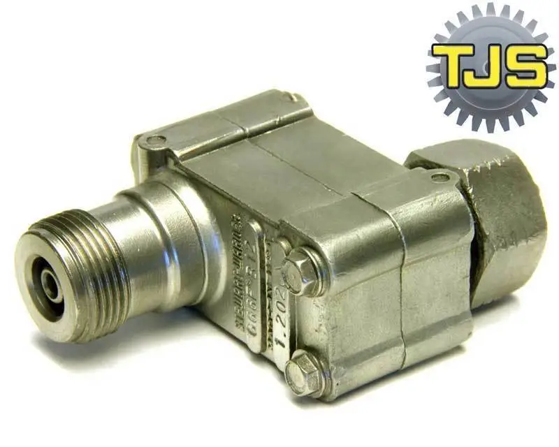

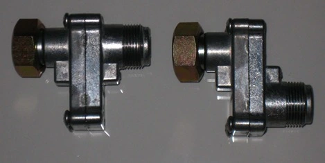

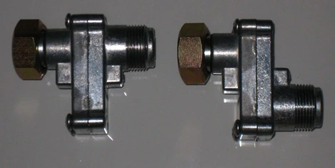

Check to see if there is a speedometer shop in your area. If there is, ask about the Stewart-Warner speedometer gearbox. I believe it is either a 777 Series Drive Joint Kits and Parts or 666 Series Drive Joint Kits and Parts. It is a small gear box that fits between the speedo pickup gear on the transmission and the speedometer. It has quick change gears that allow you to choose almost any tire size and rear end gear ratio you want. This will allow you to get the accuracy within 1%-3%. The drawback is that it isn't cheap. Cost is $95-$120 from www.gaugeguys.com
See http://www.gaugeguys.com/ratio-adapters.html for more info.
See http://www.davidsonsales.com/docs_pdf/Stewart_Warner_HD_Catalog.pdf for more information on the Stewart-Warner speedometer gearboxes.
