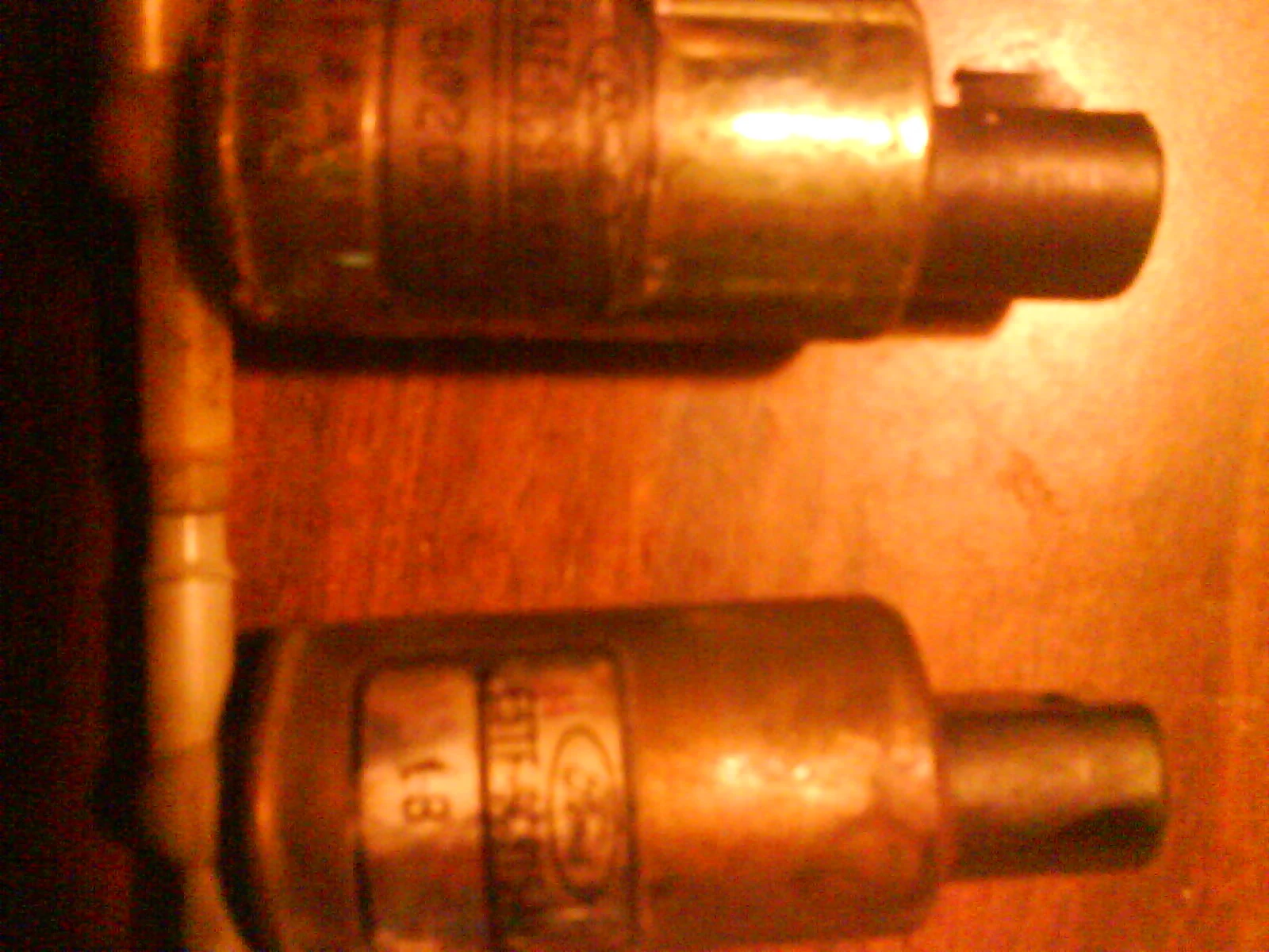

i can clear this code and with my old/original valve hooked up, this code returns in 5 minutes or less of driving but never surges the motor when it does. the replacement valve only pops the code on hot days and has a surge at the same time. you said it takes a long time to cycle purge but my car seems to try to purge within 2-5 minutes of driving from a cold start. both valves have clean as new pins and the harness plug looks great.
the ford part number is different on both.
the original valve from this V6 mustang is E4ZF-9c915-AA/B0205B.
the replacement valve is from a 96 f250 351w with part number E5TF-9c915-AA/18.
possibly the problem? the truck did not have any DTC for purge.
maybe this replacement one isnt the right part and thats why i get a surge and DTC only on hot days only?
both valve do open when i apply 12v to them from a bench test bat, then close/seal with no power. i will try to find a different valve and if that wont work ill probe some wires i guess.
weird eh? they appear to be fuly functional and exactly the same aside from the part number.

the difference in parts must be it. i did some research and it seems different pcm try to pulse these purge valves at different intervals/amounts and frequencies. i think this one for the f250 is not capable of doing the same type of pulses and the pcm sees this. you think this pcm tries to purge quickly and more frequently when its know ambient temps are higher? i think the replacemnt valve wont keep up with the rate the pcm wants to purge.
