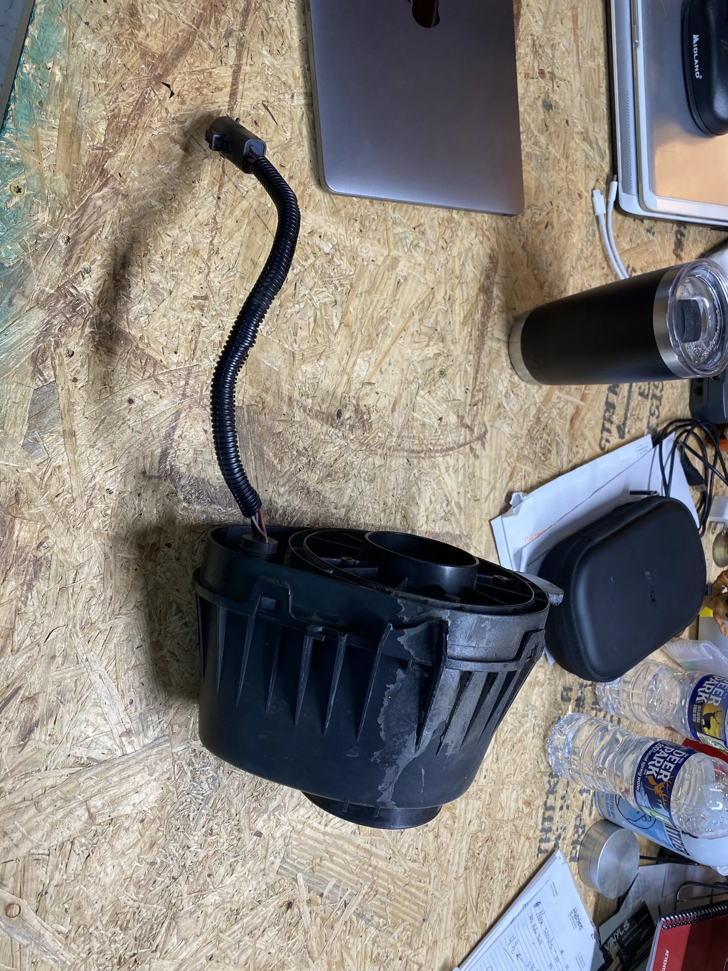

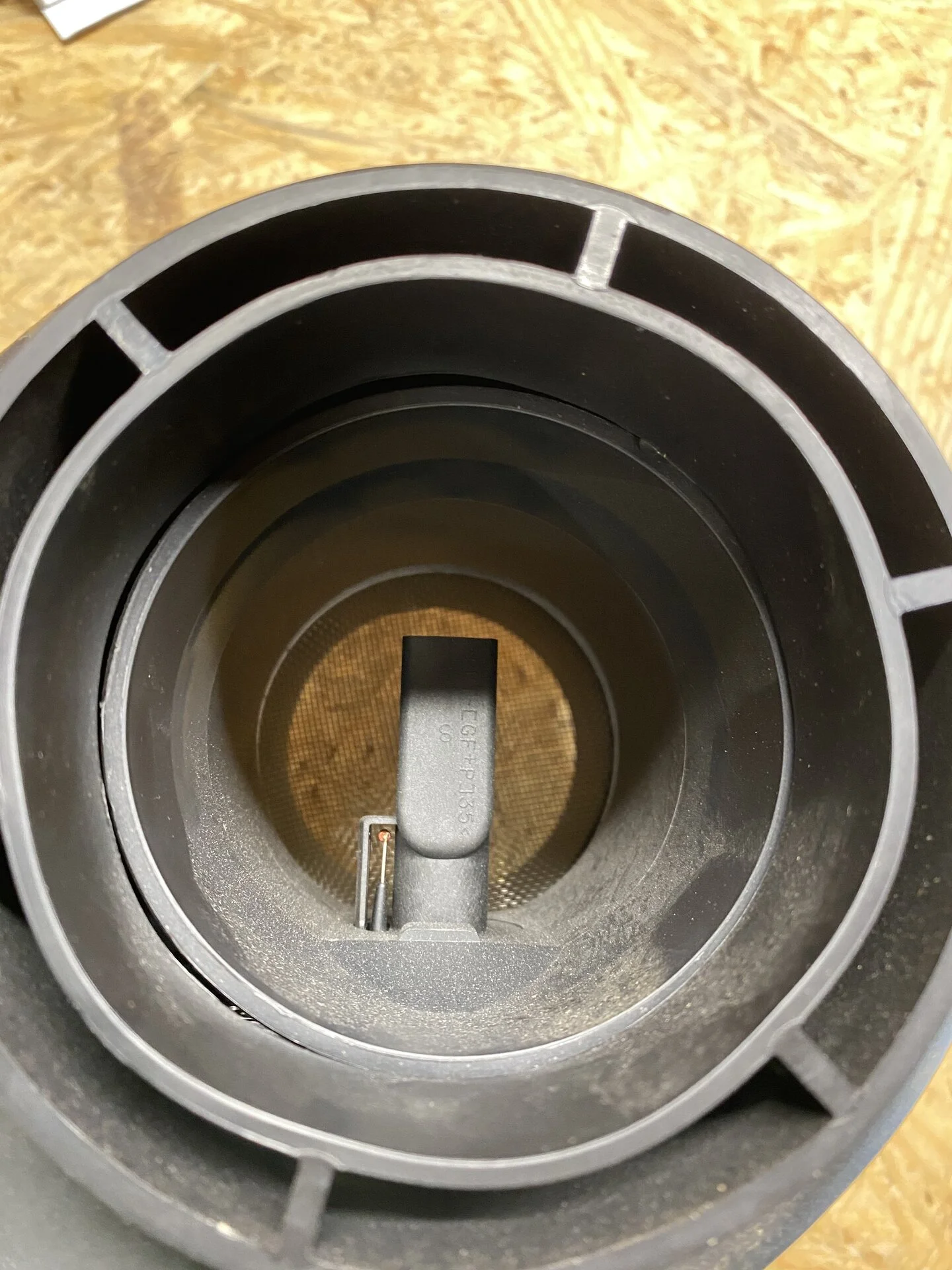

Hello everyone! I've searched but can't seem to find an answer anywhere. I believe someone swapped out the air box in my '95 with one out of an '02. Reason I think this is that the IAT is integrated with the MAF, it has a different wiring harness for the MAF/IAT and the filter housing doesn't fit correctly.

That air box looks factory to me, remember this version was designed for the then new 4.6 mod engine but still retained the 5.0 push rod engine. Even though yours is a V6. A cai will likely do nothing for performance that just swapping a high flow air filter would do.

This air box has the IAT built into the MAF, but, the duct work in my car has an external IAT...its still in there lol And from everything I found it was separate for this year but there again, im like Schultz...I know nothing..nothing. The reason I mentioned the CAI was that I do have to replace the air box, as this one doesn't fit properly in the car, or its missing parts that would allow proper fitment, and one of the clamps are busted allowing it to have a gap. The cost between finding a good used box or the CAI is comparable to each other so, may as well dress it up a bit I figured.So it is a factory box but did it come on my car?
