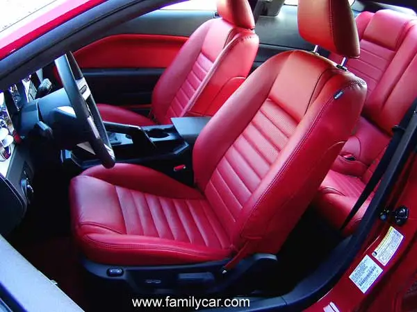

If I were to upgrade my seats I was really considering getting some of these
They're a 2005 gt mustang's seats. To me they look pretty similar to the old mustang's except they must feel so much better.
I just got a quote from the guy on ebay he said 250 for all the seats including the back. But his shipping quote was 500.... ugh!
Its so hard to find Red seats...
