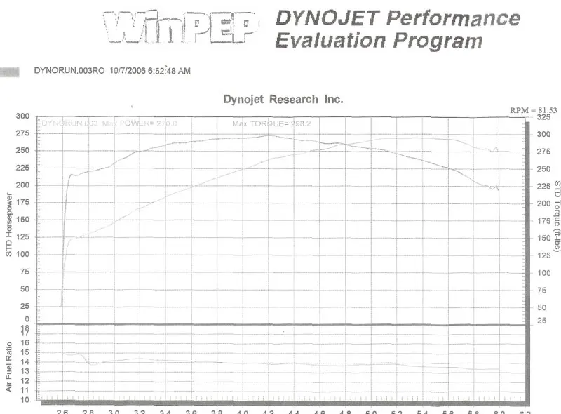

with my h/c/i n/a setup i made just under 300hp to the wheels and a bit over 300lb/ft. it was a set of gt40x heads, tfs stage 1 cam, and a gt40 tubular intake. the smaller valves and intake gave it an awesome torque curve and the mild cam kept driveability issues to a minimum. the gt40x heads are fairly inexpensive and so is the cam. to make everything affordable, you could go with the cobra intake over the gt40. it isnt as pretty looking, but gets the job done just as well.
Greg
Would you please post up the dyno pull of your sig combo when in NA form if you have that option :D
Grady
this is from a local dyno day. 87 octane and 10* timing. the first two pulls were really lean so we turned up the pressure on the regulator. i should have some new numbers within a week or two. im going in for an hour so i will get some new n/a numbers and on the bottle. i am running 93 octane and 12* on the bottle so im sure i could go a bit higher n/a.
