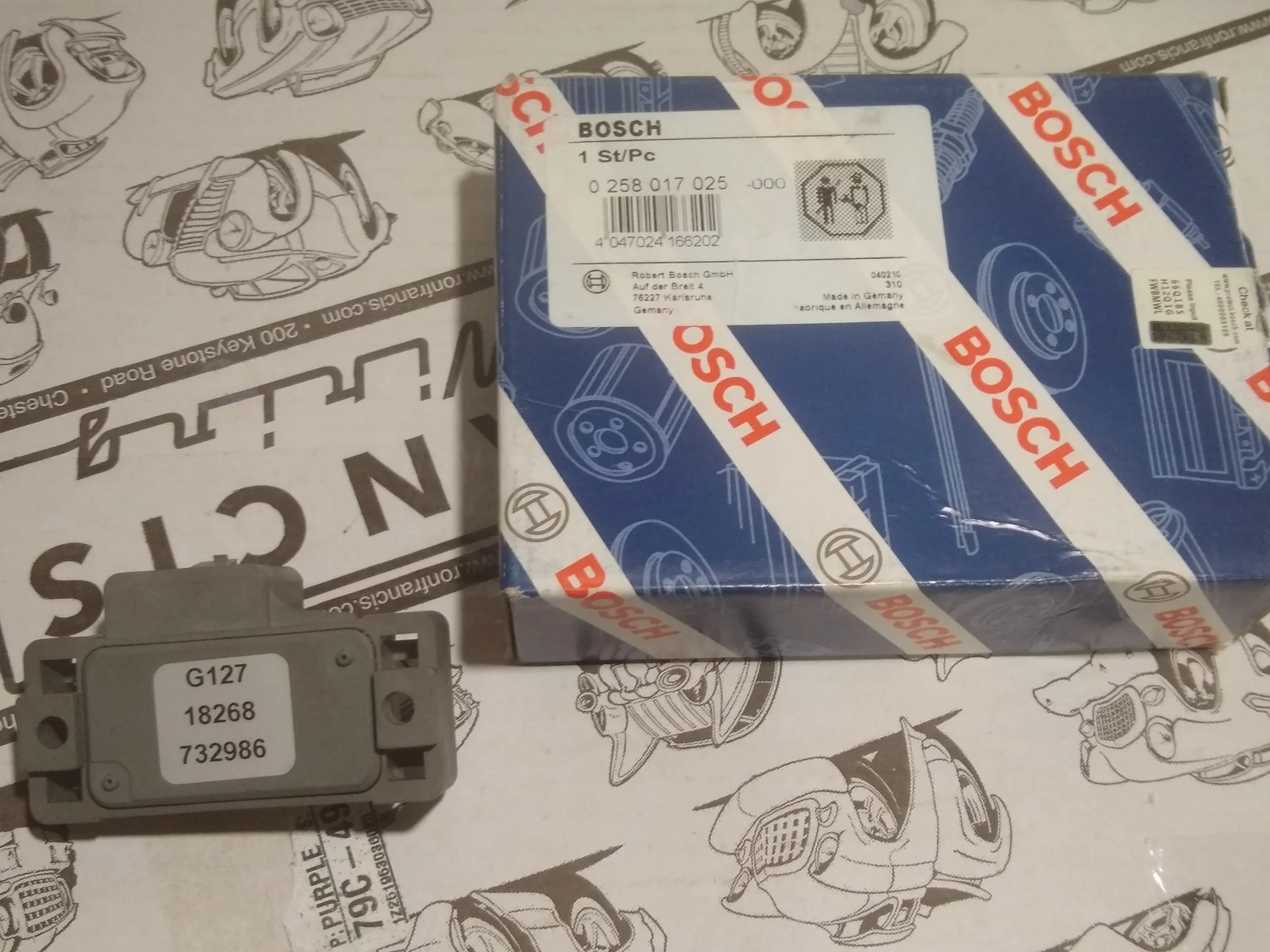

The internal MAP sucks too..With -24 inches of mercury the lil blue tube was collapsing... I had to get an external 1 bar MAP and use that too.

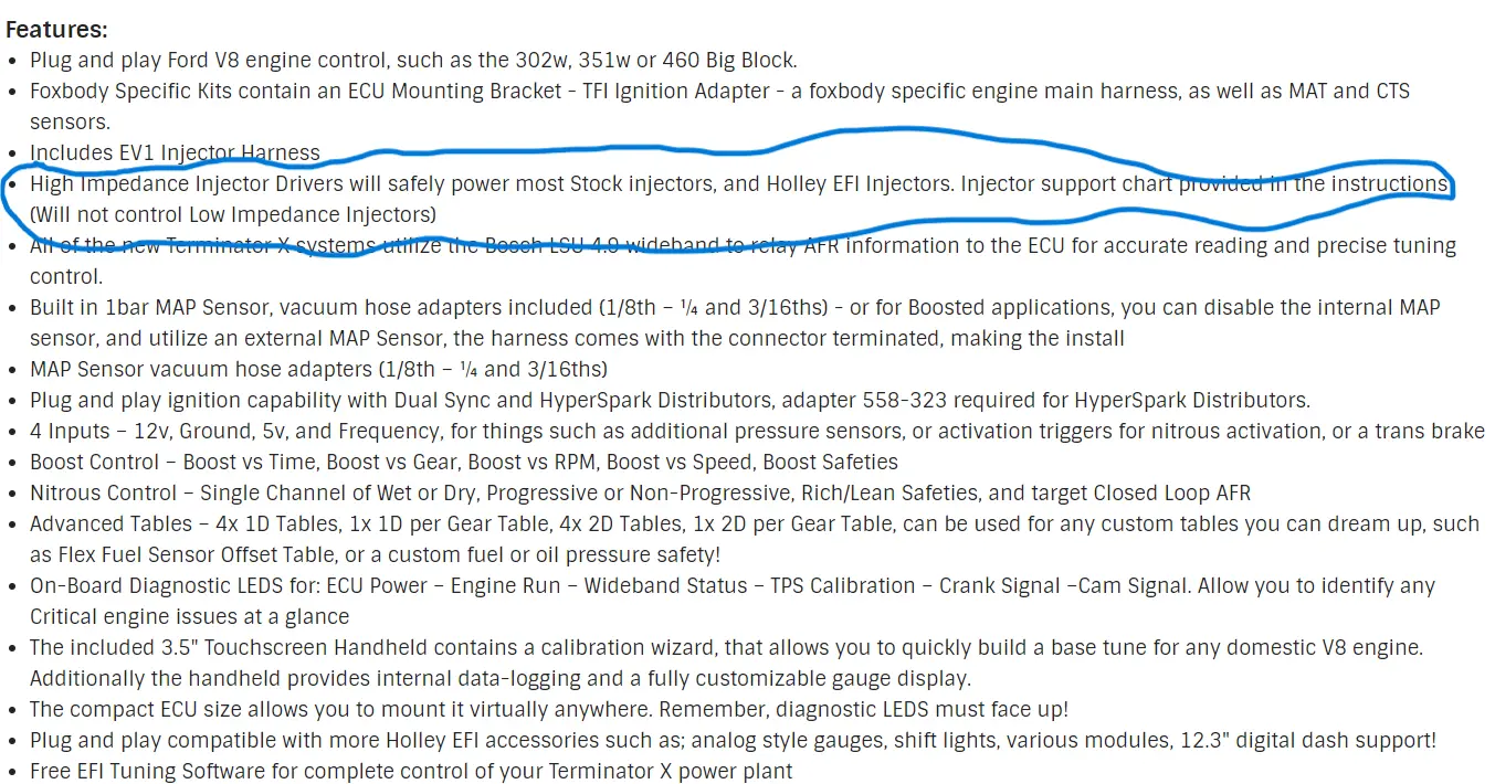

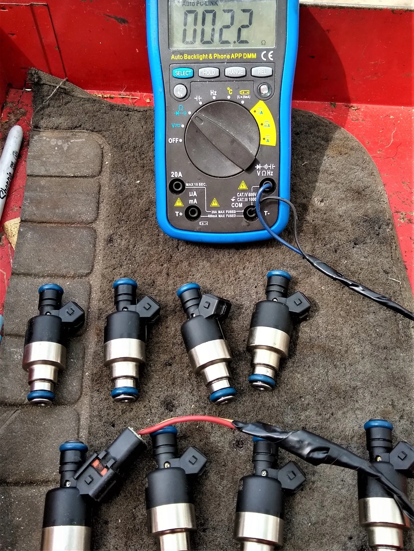

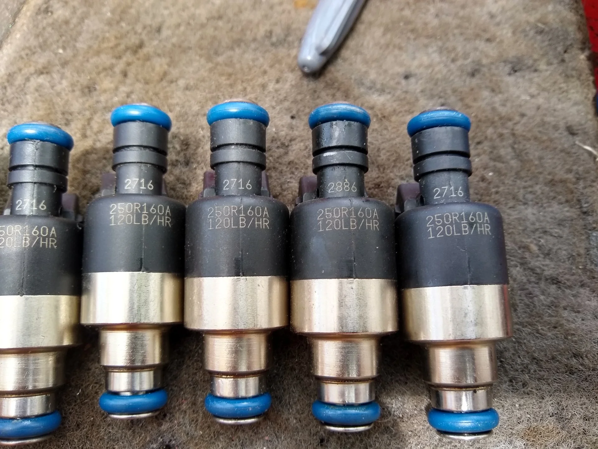

Then to mention that I ordered 36lb Holley injectors and in the box labeled 36lb injectors #522-368 unknowingly inside that box came 120lb low impedience injectors which I installed them in haste then chose Holley 36lb high impedience injectors and even though Holleys manual states you must choose the correct injector and enter the correct injector values also they state that low impedience injectors wont run on a Term X system but the wrong impedience injectors did indeed run and they ran on the wrong setting too.

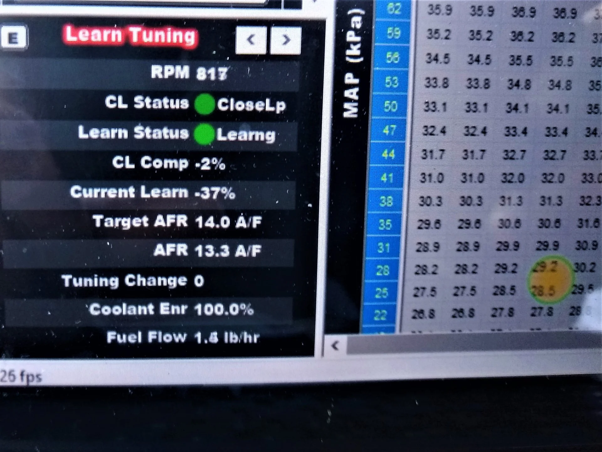

I had to cut all maps by 2/3's to get my truck to run as good as they say will run with a base map and whats funny is no expert tuner could figure out the issue looking at my datalogs and even the ones I paid were just as stumped as the generous tuner guys who took time out of their tuning schedules to try and get me ironed out for free but in the end I figured it out the hard way what the issue was when my 8qt oilpan was full of fuel from the excessive powershots of fuel that entered my cylinders in the 3.5 seconds of fuel prime that was recommended by Holley and was used.........

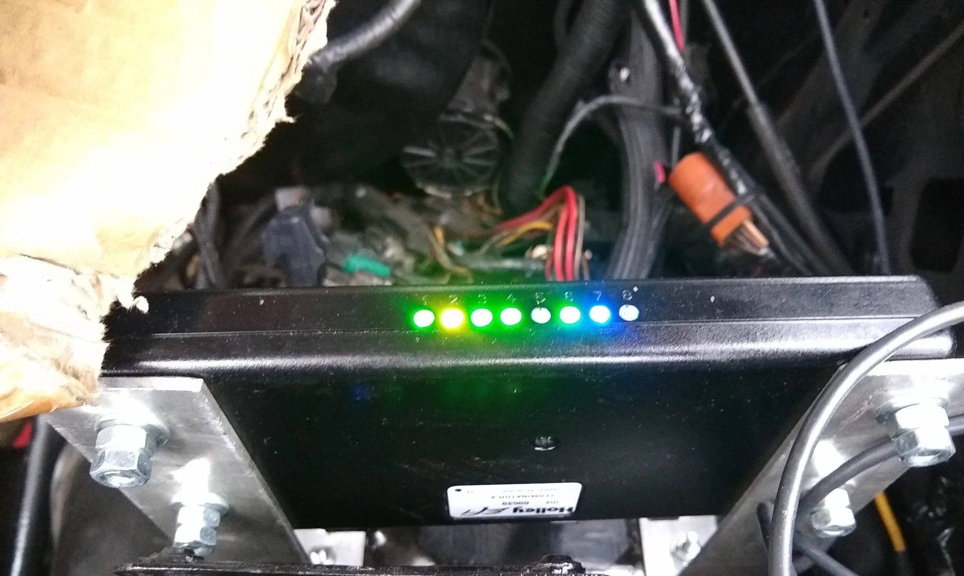

Those extra unused LED's should of been on a chip that verified the proper injectors on one extra LED and the proper sensors with correct info is entered for the setup or give a red , yellow or green at both LEDS but Holley wasnt smart enough to think of that and left two LEDS that do nothing and labeled for future use..

Had the system do what it said it wont do and thats run with low impedience injectors or run them on the wrong setting too then I wouldnt of ruined my engine if the Term X system couldnt operate as I would of found the issue sooner especially if the system was as smart as they claim and alerted me to the injector error.....

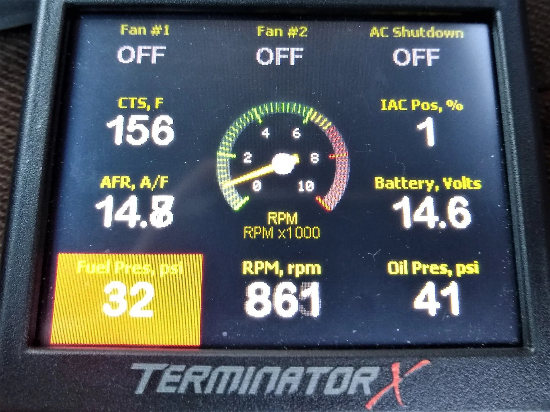

And before anyone says that with 120lb injectors my truck it wouldnt of even ran....Look at the picture of the screen////.Everything seems to look like its on par but it really wasnt.........I have a vid of it running too..It Idled smooth all day until I cracked the butterfly and released it....LOL
