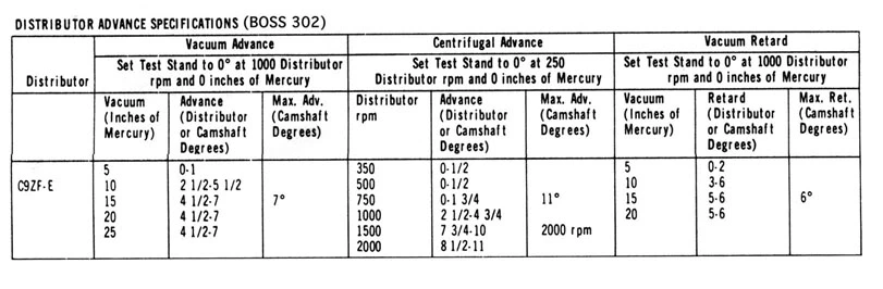

OK, stock appearance. Change from the 1.08 carb to the 1.12, which appears identical but has much better flow, as it was used in the 289HP. That's the one I'm using now. Change to the C30Z-C 289HP cam, or the C9OZ-C hydraulic version. Either flows better than your cam, and you still have stock appearance and idle.
When you recurve the distributor, use BOSS 302 specs. Your carb and cam will still limit power, I'm afraid, but it'll get better with distributor adjustment.
