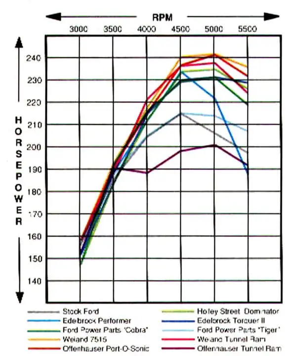

Yeah, the chief advantage the XE268 has over the Ford C7FE-A Cobra LeMans is the Comp is hydraulic. Of course, the Cobra mechanical is more stable at high rpm, so you pay your money and take your chance.
The Cobra intake specs pretty well, too. This old chart lists the Performer and Cobra but not the Performer Plus. The "Tiger" was the aluminum version of the stock iron 4V:
