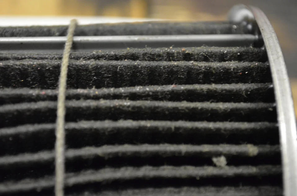

Backround: Built a 347 for my 88 Ranger. Eagle rotating assembly (fully forged), Clevite bearings, March Serpentine kit, TCI 157 tooth flexplate, TCI 3,000 stall Torque Converter and TCI C4 Transmission (Auto Valve Body). Crankshaft endplay was set to 0.005. Dropped the motor in, properly broke in and at the 300 mile mark changed oil and cut open the filter to find normal break-in shavings and copper. Immediately Ripped the motor out and the thrust bearing was ate up badly. No other bearings showed any abnormal wear. The crankshaft had almost 0.014 endplay. Installed new thrust bearing and re-set endplay to 0.005. Re-installed the motor. Grounded it out properly, it has a single trans cooler which is not linked to the radiator at all and all lines are free of kinks. After starting it up and doing a few electrical tests and some free revving for a few days, removed the filter to find no copper what so ever. (Note: Did not drive truck at all during this time. Never went into gear). Installed new filter, drove it for about an hour and removed the filter. Cut it open and found glorious copper. I hooked my Go-Pro to the oil pan to take a video of the converter while driving around the block. While under a 2,000 rpm load it appears this thing is moving quite a bit. I rechecked endplay and its now at 0.008. Also, while cranking, I noticed the flexplate would wobble more than I would like to see. All parts are new out of the box. Let me know if you need pictures of what the old thrust bearing and filter looked like. I'll send them over as requested along with the video. What would be causing the premature wear of the thrust bearing?

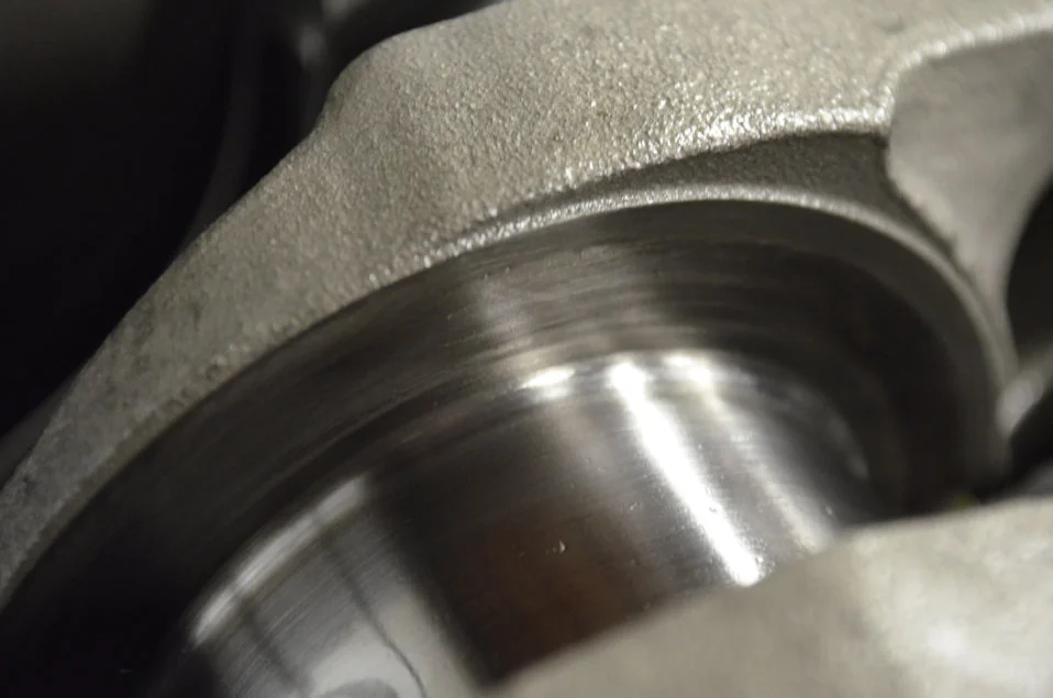

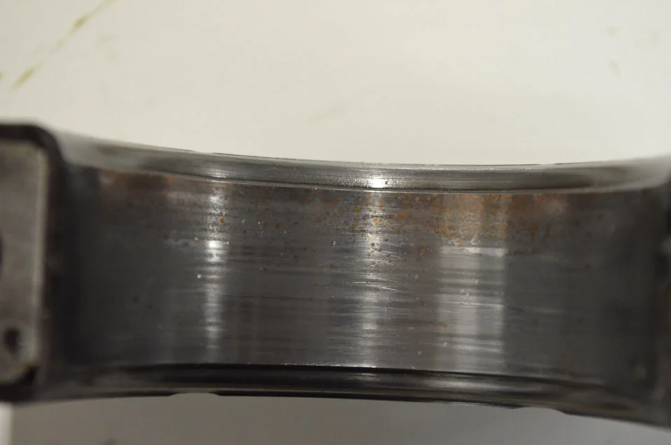

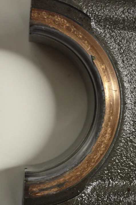

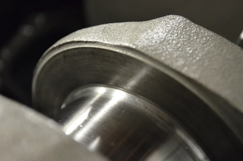

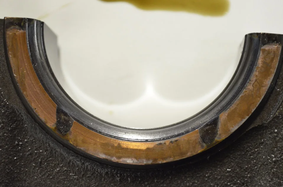

Attached are pictures of the first thrust bearing, crankshaft faces, and oil filter.

The wobbly flex plat has me a little worried - I believe that could cause motion that could stress the thrust bearing. I'd get to the bottom of that ASAP

The wobble in the flexplate is visable during cranking only. Once its running at an idle, even if I turn down the idle to a crawl, you can't see the wobble with the naked eye or with a video slowed down. i'm not sure if it's my OCD kicking in or a no **** problem. I've seen some serious wobble before on flexplates and in compairson, this is nothing. But, like you said, that can and WILL eat a thrust bearing up. Agree 100%.

Verdict is in: When I left this morning to go to work, the crankshaft endplay was 0.010. Once I got home, I measured the endplay again. The crankshaft endplay is now......drumroll........0.015! Time to take the motor back out and play doctor again. I'm not in the business blowing up motors and wasting money, so this is my only option...again. Any advice on what I should be looking for during the surgery? Last time I did it, 50 miles or so ago, I checked EVERY SINGLE BEARING and corresponding service for abnormalities and the only one that measured out of specification and looked like hammered dog **** was the thrust bearing.

84Ttop: I'm following you on your suggestions. Converter to Flexplate spacing was just shy of 1/8 inch. With that being said, its possible the Flexplate may be flawed. Talked with TCI again and they want me to send them the Flexplate for inspection. It concerns them that the ring gear was welded on crooked, about an 1/8 inch difference from once side to another...so, a measurement on one end might be 1/8 and the other...well, who knows if its really crooked by 1/8 inch or, the misaligned ring gear could be throwing everything out of rounds and balance while rotating. They also said it could cause the thrust bearing wear and possibly a rear main seal leak. I did see small traces of oil on the bell housing interior upon disassembly. Haven't looked at the seal yet, still dealing with holidays and birthdays so, soon enough hopefully to get the Flexplate off and sent out to TCI. The rear side of the thrust bearing was worn, transmission side. As for the crankshaft; the first time this happened I had it checked out by the machine shop for wear and other things that were mentioned in previous posts. All check out perfect. They said if I didn't tear the motor down, it would have been a very expensive paper weight. I will be sending it back out again. I might just send the entire motor out to get everything rechecked. That might take a while though, recovering from holidays and soon Hallmark Holidays.
I would be sure that the converter is not too loose, does it have ballooning plates? I've seen the rearward thrust face destroyed in more than a few motors from an improperly setup torque converter.
