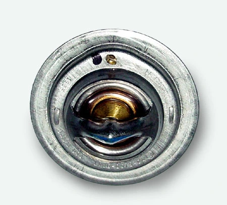

Also, when you put the thermostat in, did you drill a 1/8th inch hole at the top to help the burping process?

If you use the genuine Ford thermostat with the air bleed valve, you can avoid this entire song-and-dance.
