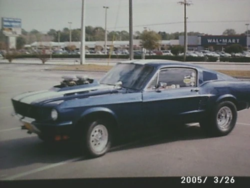

Ist engine...
It is lke anything you do for the FIRST time... just think on it and remember.. it is only a hobby!! AND fun!! LOL
Have fun....................
Thumper
PS This poor Fastback has over 20 different engine combos since I bought it new!! And probably MORE to come!! LOL
