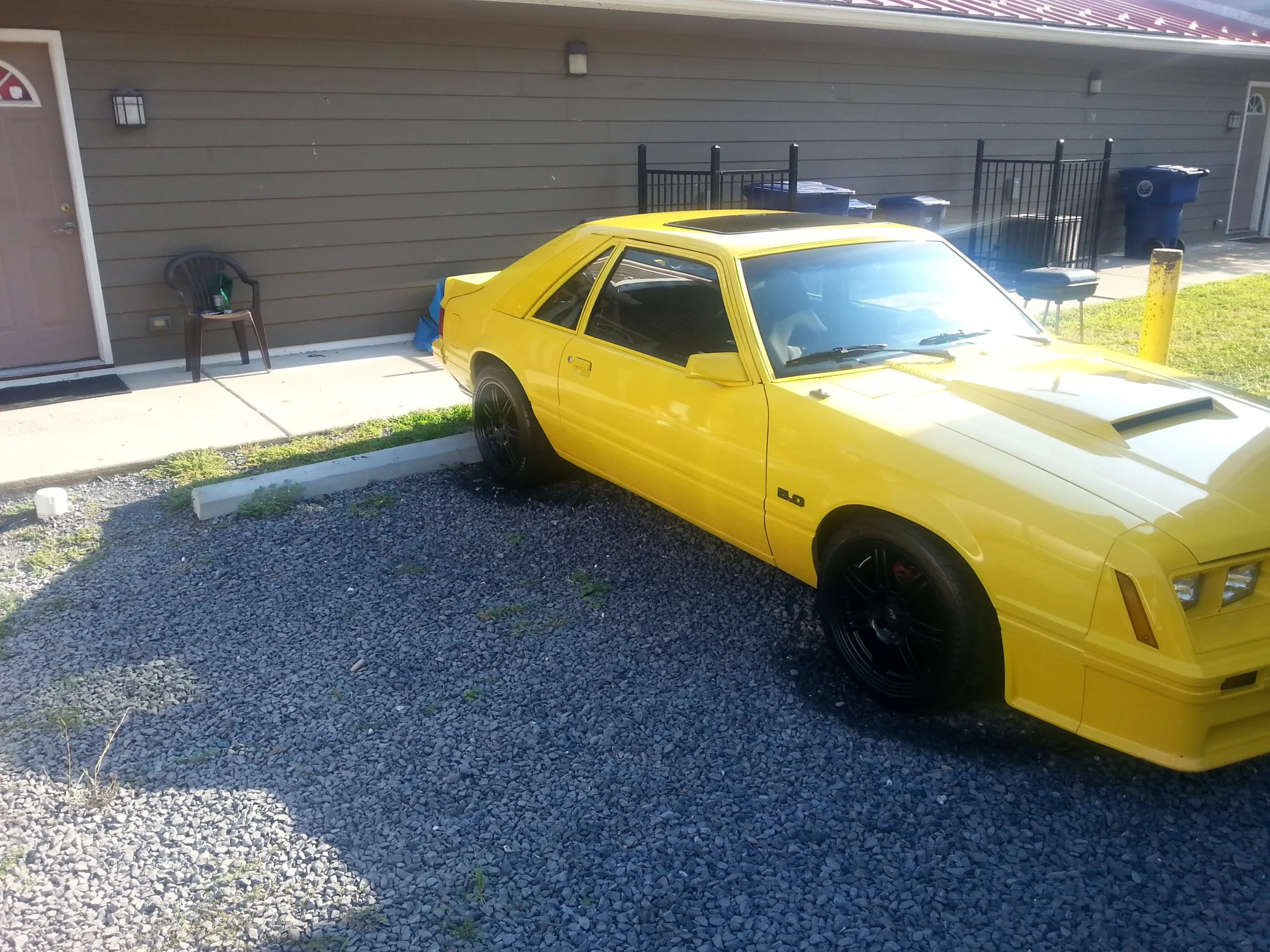

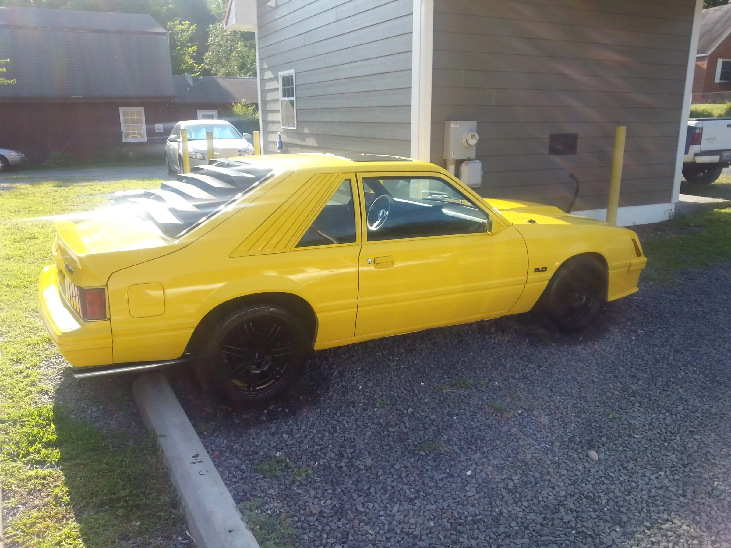

Now, lets see some pics of that potential money pit and keep us up on what your do'n to it.
Work in progress
