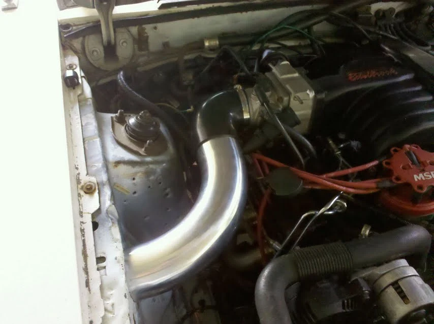

I run ported explorer heads and intake with the stock 87 ho cam. Bbk Shorty headers and off road h pipe. 5 spd tranny with 3.27 gears. I also made a home made Anderson style power pipe since my car had a ghetto cai that had an open filter on top of the pass side header. If I keep my foot off the gas I can get 17 city and my best hwy run was 24mpg at 70mph.

Ghetto cai...hmmm? Not following
piece of tubing attached to an open air filter that was hanging on top of the header sucking in 200* temps. a decent cai will have a closed air box taking air either from the fender or from the front of the car. possibly one of the best setups is the stock 5.0 air box with the baffle removed but seeing as how you are doing a swap this may not be an option for you unless it comes on the donor car and I will be honest. most of these have been relocated to the garbage can a long time ago.
Here are a couple mock up pics
http://www.stangnet.com/mustang-forums/attachments/pipe-jpg.65520/
http://www.stangnet.com/mustang-forums/attachments/img_20110219_154504-jpg.65519/
Here is the link to the thread where others beside myself have done this. I cant take credit.
http://www.stangnet.com/mustang-forums/threads/check-out-my-homemade-power-pipe.770054/
