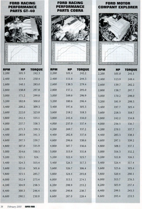

The Cobra intake off a 1993 Mustang Cobra, Explorer Intake off the 96-98 5.0 Explorer or Mountaneer, and the GT-40 Tubular Intake (off a lightning i believe?) are all essentially the "same" intake. They all have the same lower, its just the uppers that vary in design. They all flow pretty much the same. Heres a dyno graph showing all 3 intakes on the same engine.
The explorer intake managed to reach a higher peak hp than all, but the gt-40 tubular made better overall power and torque than all 3 of the intakes. The Cobra intake performed excellently as well. I am on the same boat as you midnight95 (similar mods) and am planning on buying a tubular for my 88 5.0 by the end of this year. Theyre a little more pricey but they look sweeeeeet in the engine bay!
