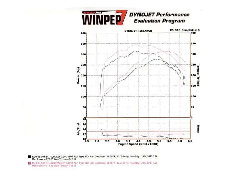

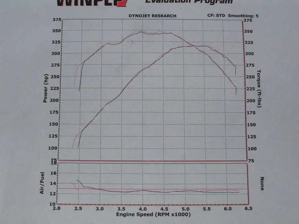

Ok, recently swapped in a 331 stroker motor. Have a C&L Maf calibrated for my 30lb injectors, AFR 185s with FTI upgraded spring package, Performer RPM intake, and an FTI custom cam (Gross Valve Lift: .5728 / .5632; Duration 224*/ 228*) with a powerband from 2800-6100. TPS voltage is at .97.
I've included both my dyno sheets and have some questions on what to do.
Original dyno run showed that the car was running pig rich with fuel pressure at stock levels. Dropping that fuel pressure to 35psi netted some decent gains.
On next trip, fuel pressure was dropped to 28psi and the A/F ratio got a little better but netted only 4hp more.

1) Given my parts, shouldn't I be expecting more out of my engine than I'm getting? I was expecting more in the 360hp range.
2) I am going to swap a Pro-M MAF in and see if that improves my A/F ratio. If my MAF is somehow off, could it be the reason that the car is not performing as well as it should? My friend said something about how even though you can compensate with the AFPR, if the MAF is off, it'll still throw the timing advance and whatnot way off. Is that true? Do I need a base fuel pressure of 40psi for everything to work optimally and then work with maf adjustments, or does it not matter as long as you get a good A/F ratio at the end
3) Do I have some sort of bottleneck or mismatch that is causing such an early and massive dropoff in power? Do I need a bigger intake?
4) I was planning on running nitrous and have a SCT chip. Will this chip and some good dyno tuning cure any problems I might be having?

Aliate X said:
If you look they have the smoothing set on 5 and your still showing fluctuations.
Good point.
How much timing are you running? You NEED to get that fuel pressure back up to 40 psi. Try putting the FP back to 40psi, then disconnect your battery for a while to erase the KAM (keep alive memory)
What are you running for exhaust? It should still make good power even with the smaller unported RPM intake.
On that note, when I switch MAFs, I want to have the fuel pressure set at stock levels. Seeing as how the fuel pressure is so low right now, is there a certain amount of time that the computer takes to compensate, or is it as easy as bumping the pressure back to 40, unhook the battery, switch MAFs and fire it up and the computer will be on track?
Yes, if the MAF is calibrated for your injectors, you do just that. reset fuel pressure, swap out MAFs and disconnect the vbattery before you start work on ther MAF. Should be disconnected ~20 minutes or more. That resets KAM and erases your Adaptive multiplier.
Edit, if that RPM I is not ported, it will hold back some level of power on that 331 and that cam. The "CNC" match at the upper-to-lower flanges is a joke and both pieces need work there - then the lower is restrictive @ the head flange for 185 heads. If you don't want to work that intake, try an RPMII or Holley.
Did you ever replace the bad Baro sensor that gave the code 22 from last time? That will seriously mess up your A/F. Do you have any new codes?
