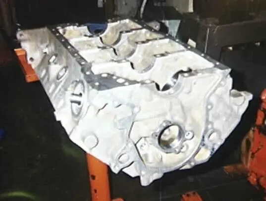

Blocks....
As mentioned get a quality block. I opted for a 69-70 boss block and it cost 1100. Not only are they a hi po part they are highly sought after by the boss people. I'm sure that most of the people on the forum have heard the myth of the Mexican block. In std bore or .010 it will take 600. I don't believe it. I've heard too many people say that it won't hold up. Keep in mind that just comes from what people told me. Not personal experence.
There really is no myth to the mexican block, they are by far stronger when compared to a late model block, all it takes is one visual look at the main webbing to see. The other higher nickel content theory is mythical. The mexican block will handle some serious power. I have 1 member running a 306 all motor, 2860lbs, car goes 10 teens. Do the math on that one. Will go 9.90's very shortly with a few small changes.
giddyup306 said:
I won't confirm or deny it untill I see it for myeslf. Like I said I have no experence with the mexican block.
look at the main webbing, its glaring
