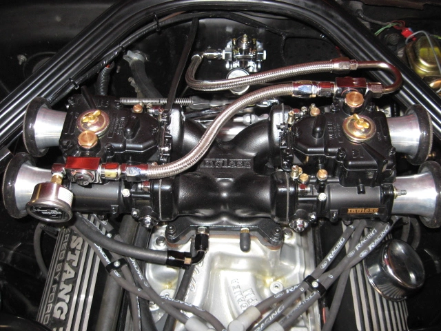

Hi,
I"m running a 289/334 (.040 over), TW 170 heads, 10.6 CR, 680 custom designed Holly, Performer RPM, full roller conversion, custom designed cam (.570/.562), TRI-Ys, 2.5" exhaust system, and a Jacob's ign. system. My junk dynoed at 392 RWHP at 6100 w/402 RWTQ @ 4200. My rotating system is not forged, but, is a high quality cast system with all of the assembly blue printed. I do no drag-strip, mainly cruise and shows. To-date, I am running a dual DCOE Weber setup and the car "does go".

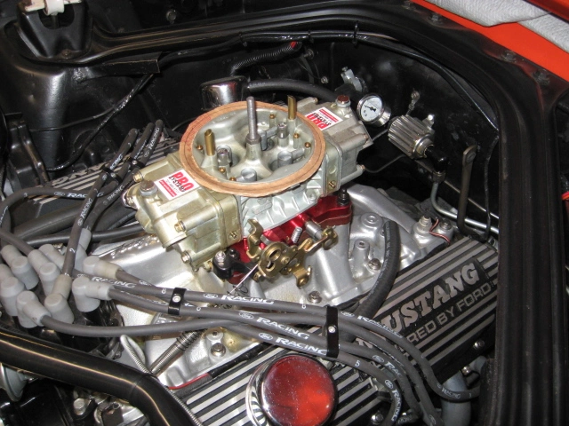

Hi,
My best advice..no one can answer that question, even with what might be considered a similar builds. This being stated, I suggest you access ProSystem's site and complete their engine profile spec sheet and submit. It will not be a cheap purchase, but, it will be a custom built carb for your engine that will work OTB (out of the box). This is why mine is "680", not 650 or 750. It's specific to my engines breathing capabilities.
Also know, unless they have relented in the past couple of years, you will not get a carb with a choke. But then again, their builds do not need one. Here is the one I ran.
