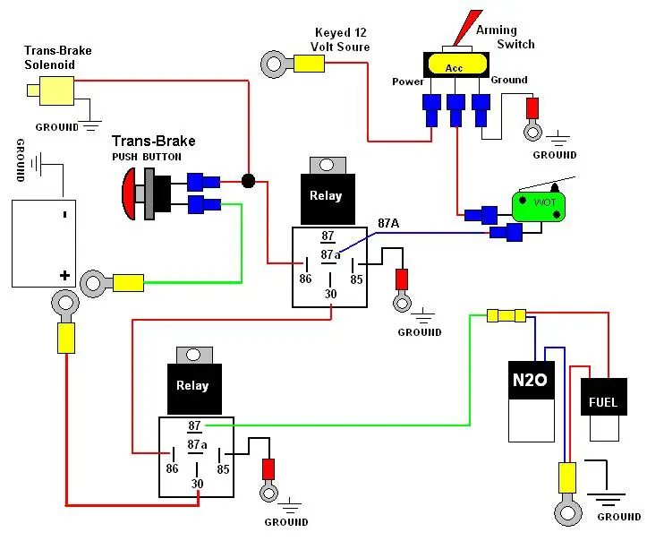

I have a transbrake and the nos is set to work at full throttle. However the last 2 times I have the transbrake the nos didnt come in. It works fine if i footbrake the car. But when i footbrake i only get the stall up to about 2700 rpm before the car starts to move. I got have someone go back through the transbrake setup to see where the error is happening with that. And the car is run on 110 or 114 octane racing fuel.
You guys are amazing. Thanks for the transbrake info. cant wait to get off work today so i can redue the transbrake. I think im going to increase my stall to a 4500. The company is about 3hours from and the guy said he can change this while i wait if i drive down in the a.m
