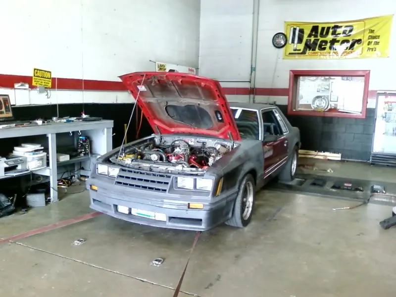

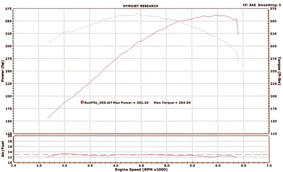

Well, stopped by my local speed shop today www.CincySpeed.com - Home and managed to sweet talk my way into getting squeezed in for some spur of the moment dyno time. To make a long story short, it was filthy rich and total timing was 42 degrees when i drove it in (and amazingly enough it didn't ping)! They took great care of me, jetting it down/up where needed, dropped total timing down to 35 and ripped the rollers. Here's what i got:
Not bad for 40 year old heads huh? I'm probably at the stage where i could start to use a nice single plane intake and possibly even a 700cfm carb. It runs stout as hell now :rock:
Overall i'm pretty damn happy with the numbers considering how much more i can do to it. I can go single plane intake, bigger carb, recurve the distributor, obviously get better heads...all that should put me a good bit past 400rwhp.

Hey if you believe the whole 15% drivetrain loss thing, that puts me at 416hp/418tq. They also said it's typical for drag radials and slicks to rob you of a few ponys.

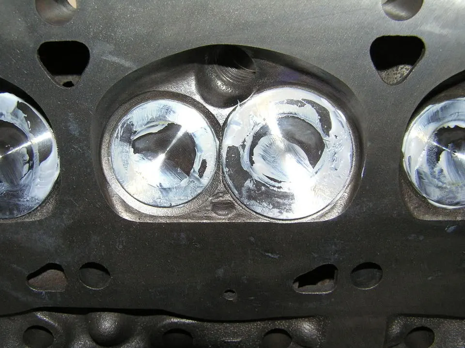

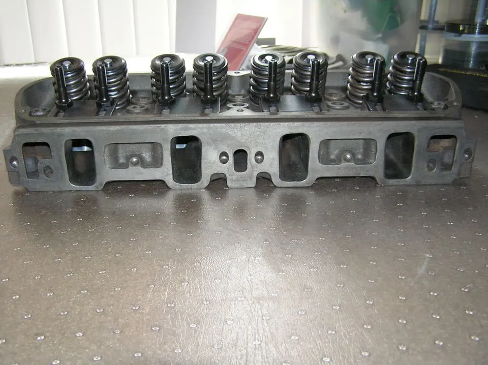

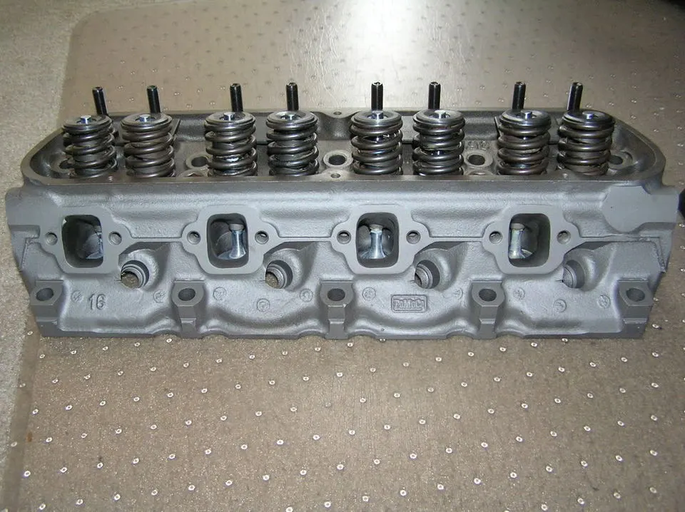

Then again, my heads are pretty seriously ported...i'm starting to believe the story about them coming off of a dirt track car. When i got them, they each had a bent exhaust valve and when i took them to the machine shop i asked the guy to give me an honest opinion of the port work and tell me if it's even worth messing with them, and he said he hadn't seen hand port work like that in years.
Here's a few pics of them for anyone who's curious.
