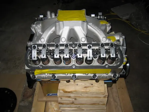

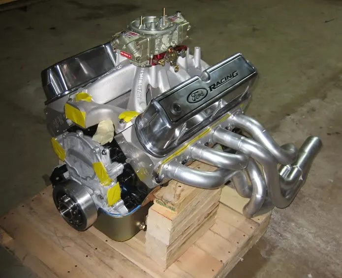

Depends on the application but I am with Mike if you want to go with a aftermarket block go 4.125" bore, 5.4" rod, 3.4" stroke 363ci.. I just finished one last month for a customer, very nice trick piece. Depends on budget and application..........
Properly assembled the 5.4" vs 5.315" rod is a joke, they WILL NOT BURN OIL.
That engine is just pure sex Rick!!! I just got down telling a buddy of mine that is looking to go low tens NA to build a dart based stroker with a 4.125" bore and a 3.4" stroke crank to end up with a 363 cube small block. I want one so bad after talking with him, damn I need to hit the lottery!
