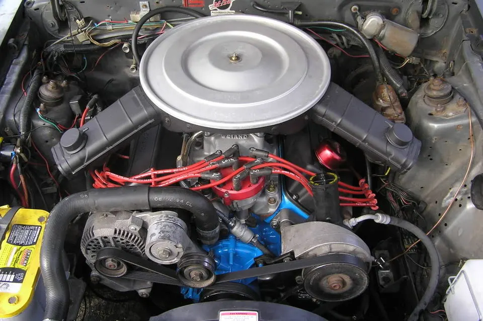

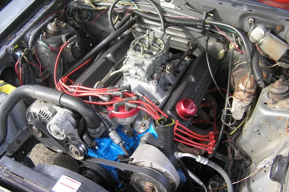

Oh perfect....now my brand new Holley fuel pump is pissing gas out of the gaskets.
Oh well...here's a couple pics anyways. Still pretty low key looking setup which is perfect for keeping it semi-sleeper. I don't know if the cam lope will help though..lol. I still need to clean up a bunch of stuff and i wanted to get all my brackets bead blasted but i was pressed for time so i had to leave them all crappy looking.
