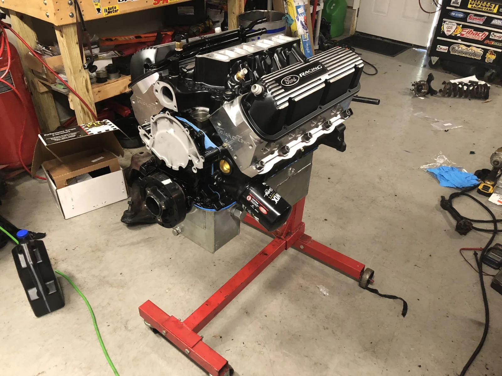

Hey Guys!
This might have been beat up on some prior thread, but I didn't find any confirmed part numbers and such.
I have a 347 stoker engine with a stock oil pan and oil pump. I recently pulled it out for some maintenance under the hood. I wanted to put a windage tray in there and call it good. After playing around with a windage tray and stock pan I quickly ran into some clearance issues.
Anyone suggest oil pans with built in crank scrapper?
  • Is a high volume oil pump worth it? What part number?
  • Does this require a new pickup tube with the new pan, oil pump combo? If so what part number?
  • I really appreciate everyone's insight as there is so much to root through online.
