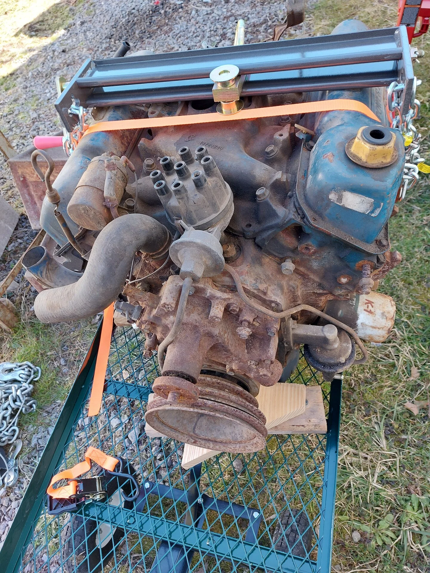

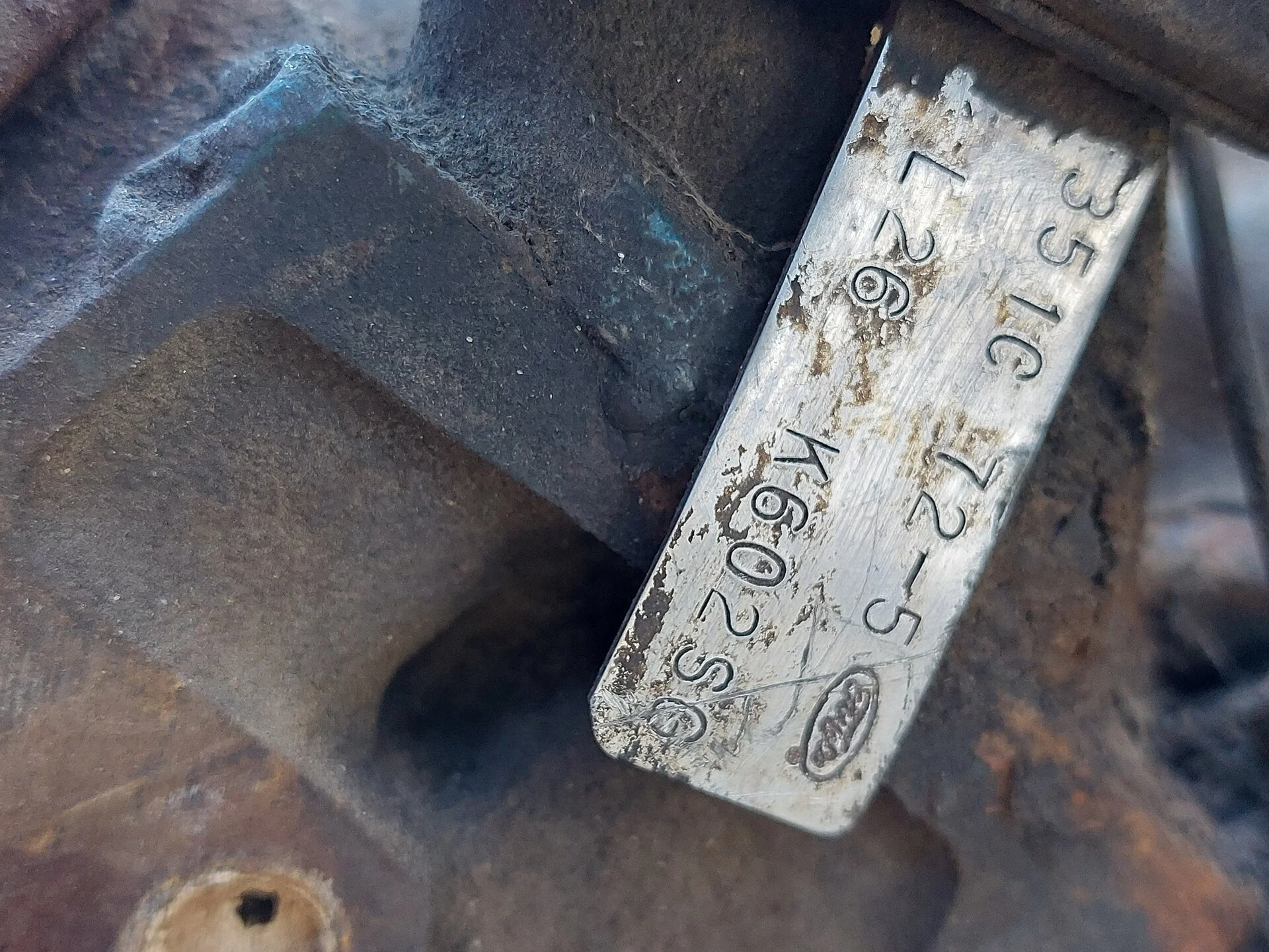

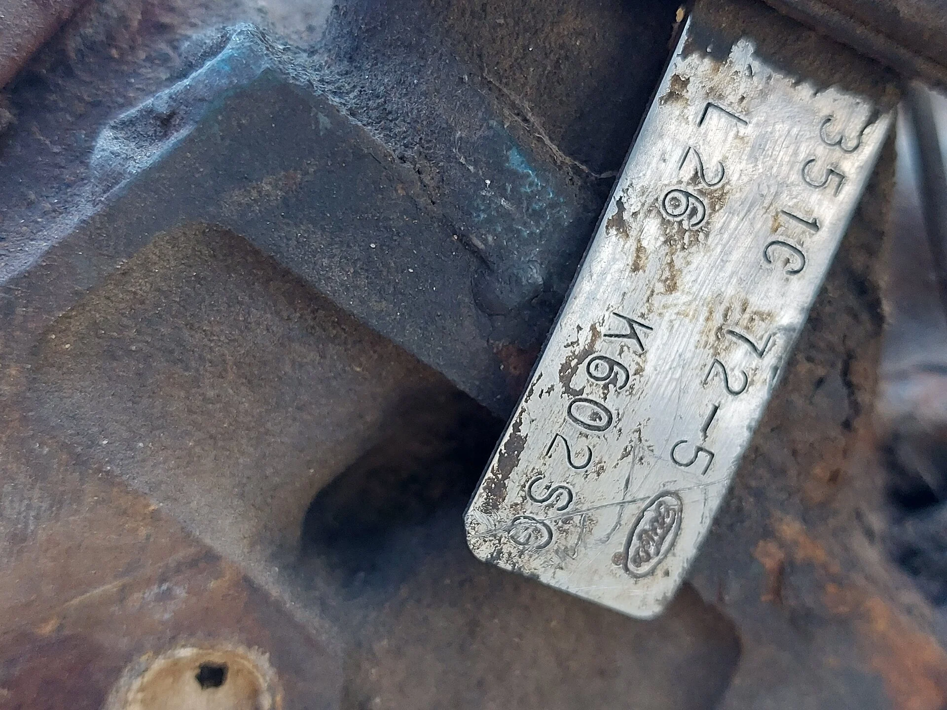

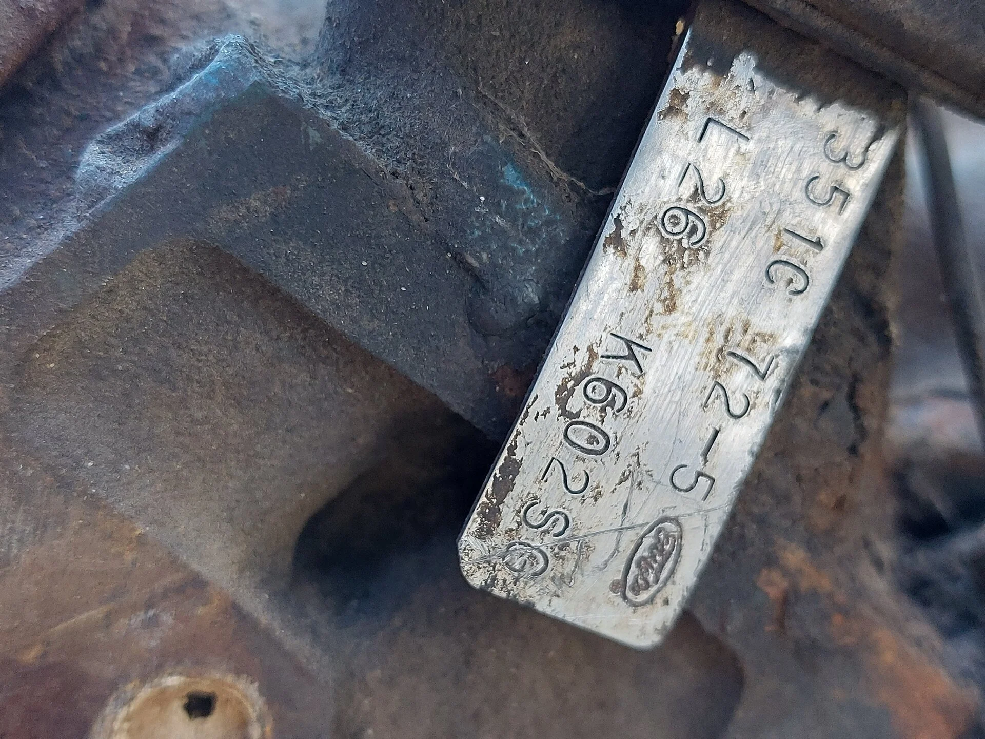

Here is one of
my K code 1972 351 Cleveland ...

They do exist cause I have 2 of them.. only 80 produced that I know of.
Actually Edgar, the engine code being referred to is the 5th digit in the VIN. In a 72 Mustang, no such thing as a "K" code in the VIN. The "K" in your pics is an engineering number for that particular part.
F302-2V
H351-2V
L250-1V
Q351-4V
R351-4V HO
These are the choices for 1972
