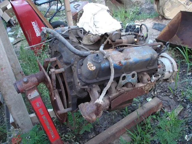

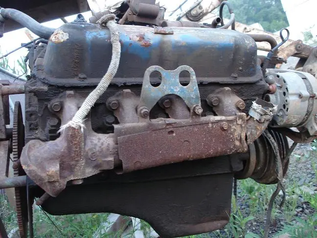

Here's the new info....evidently it did not come out of a truck it came out of an old fairlane with 60k miles on it....the motor had no problems while in the car but was swapped out to put in a bigger engine. Here are some pics of it....it looks like hell on the outside but i mean im only going to be usin the block....100$...should i even bother with it

If your not gonna make big horsepower then Id suggest getting a later model 94+ 351 roller block. That way you can swap all the majority of your 302 roller cam parts into the 351. Flat tappet vs roller is a hot topic but I feel roller has more benefits if this is a daily driver car (my opinion). You can usually find roller blocks for like 400 bucks although finding it local might be challenging.
Don't quote me on this but I think I saw a thread on Hardcore a while back that was about using rollers in early Windsors.
Something about the bores were too short for the longer rollers to allow reliable use.
