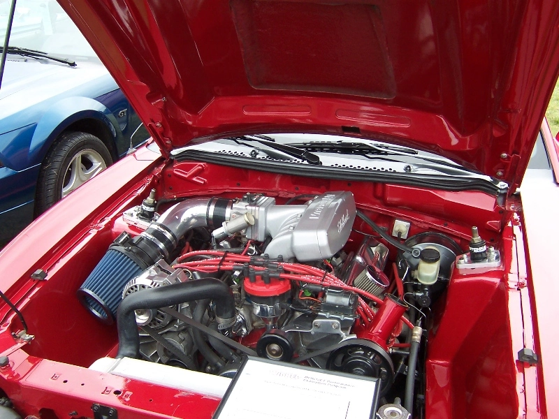

if you got a bay shot i would like to see that also
here's mine ... it is not yet finished ...

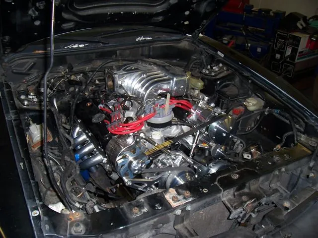

Here's a pic of mine :)
