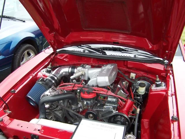

Yeah if it was me I wouldn't run the intake in your pic. They are great intakes for 302's not so good for over 400 cubes.
The other thing I didn't mention in my first response that you brought up was the cam. People get cams that were made for 302's or 289's or 260's or 221's they all fit in a 351. So they think man I know a guy who has this cam and it was really radical, but it's not when you put in in a big cube motor. Were talking 33% bigger than a 302. If you have the heads that will flow for a big motor and put a small cam and intake made more for a street 302 you will give up 75-100hp on the top end. You will still have more bottom end than any 302 anyway!:D

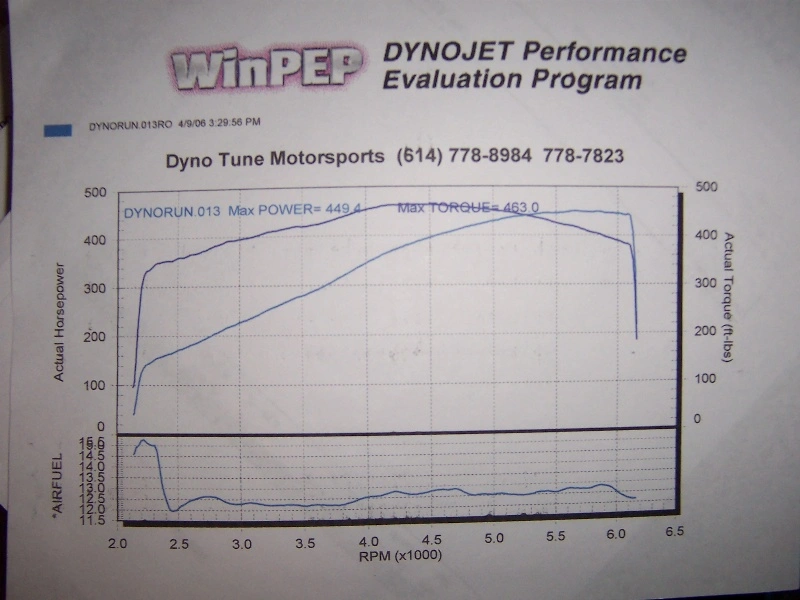

The 4000+ range they list shouldn't scare you. I can tell it really picks up around 3500, but it has plenty of torque down low. At 2300rpm, Im making 350rwtq. It peaks at 4100-5000 with 463rwtq, and it pulls strong past 6000.
Edit, I'll go ahead and throw my dyno sheet up here. :)

well i was refering to 351 based block guys sorry......i think i will be going the victor route too next concern is with the elbow and tb...do you guys have issues with the oil fill tubes?? or does it clear it fine...i though i saw lows engine with the breather on the other side
I have two breathers on mine. The Victor is a "race only" piece so it doesn't have anywhere to put a PCV. Your best bet for a tb would be to switch to a fox-style. I don't know if an elbow adapter will work on this intake....Maybe with a big spacer on it. I had to use two EGR delete plates to get my fox tb to fit right.
Side note for Grady, last time I checked the RPM 2 was not available for the 351. Just an FYI. :)

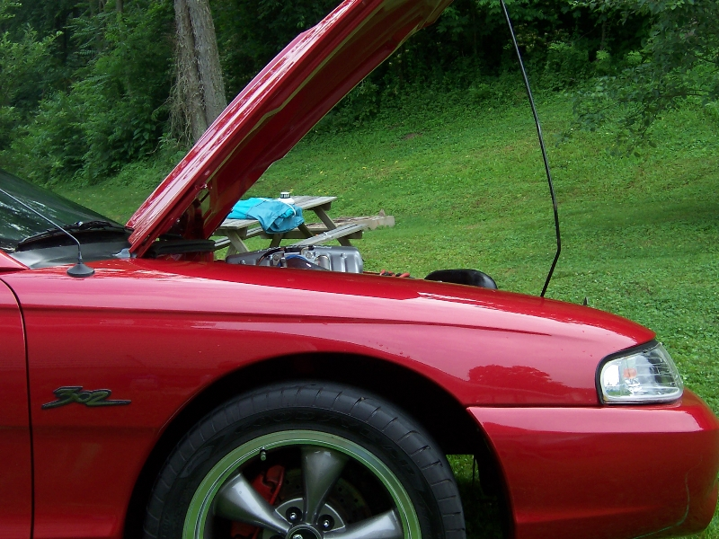

Also, I don't think it's possible to fit the Victor under a stock hood. Dropping the engine and moving it back 1" will get you close, but I don't know if that would be enough.
