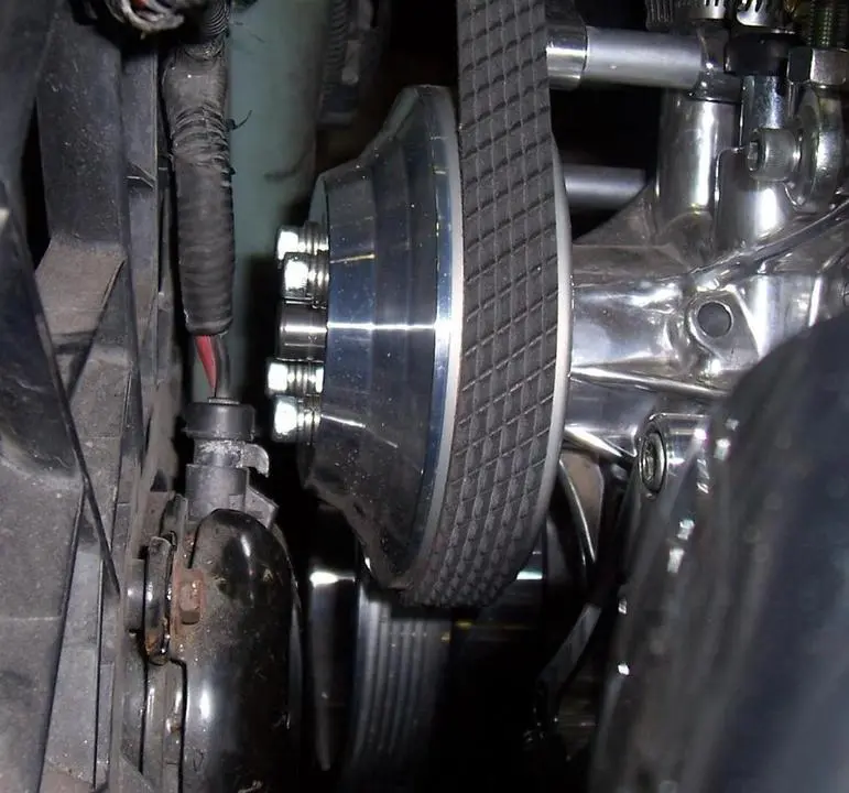

i went all out and got march pulleys and new polished fox accessories. but the point here is that now there is very little clearance between the water pump pulley and the fan. march doesn't make brackets for 94/95, at least they didn't last fall ... :shrug:

"but the point here is that now there is very little clearance between the water pump pulley and the fan"
Can you elaborate onthis BV? clearance? since you put the marchs on? in general?:shrug:
i had my mind set on march brackets. but since march did not have brackets for a 94/95, i decided to go with fox accessories (water pump, power steering, crank, a/c). now as you know, one difference between fox and 94/95 accessories is that the fox ones are located further away from the motor, by about an inch or so (which is why you need a spacer on the snout if you use a 94/95 kb on a fox). that moves the belt and all the pulleys that much closer to the radiator. the closest spot is between the water pump and the fan. and apparently, there is not much space between them now.

here is the pic my mechanic sent me. he said:
Scott said:
The one pic I am sending is of the water pump to fan clearance. There is hardly any. I hope it doesnt hit. This engine has the old style timing cover/water pump (the long style on 93 and back stuff) which sticks out further and makes for a VERY tight fit. Hopefully it will be ok.
i think the worry is that even though there is some room there, but the motor does move a little from the torque (even a stock 302 moves). but that is usually side to side, not front to back. i'm thinking that maybe an after market fan might be thinner ...
